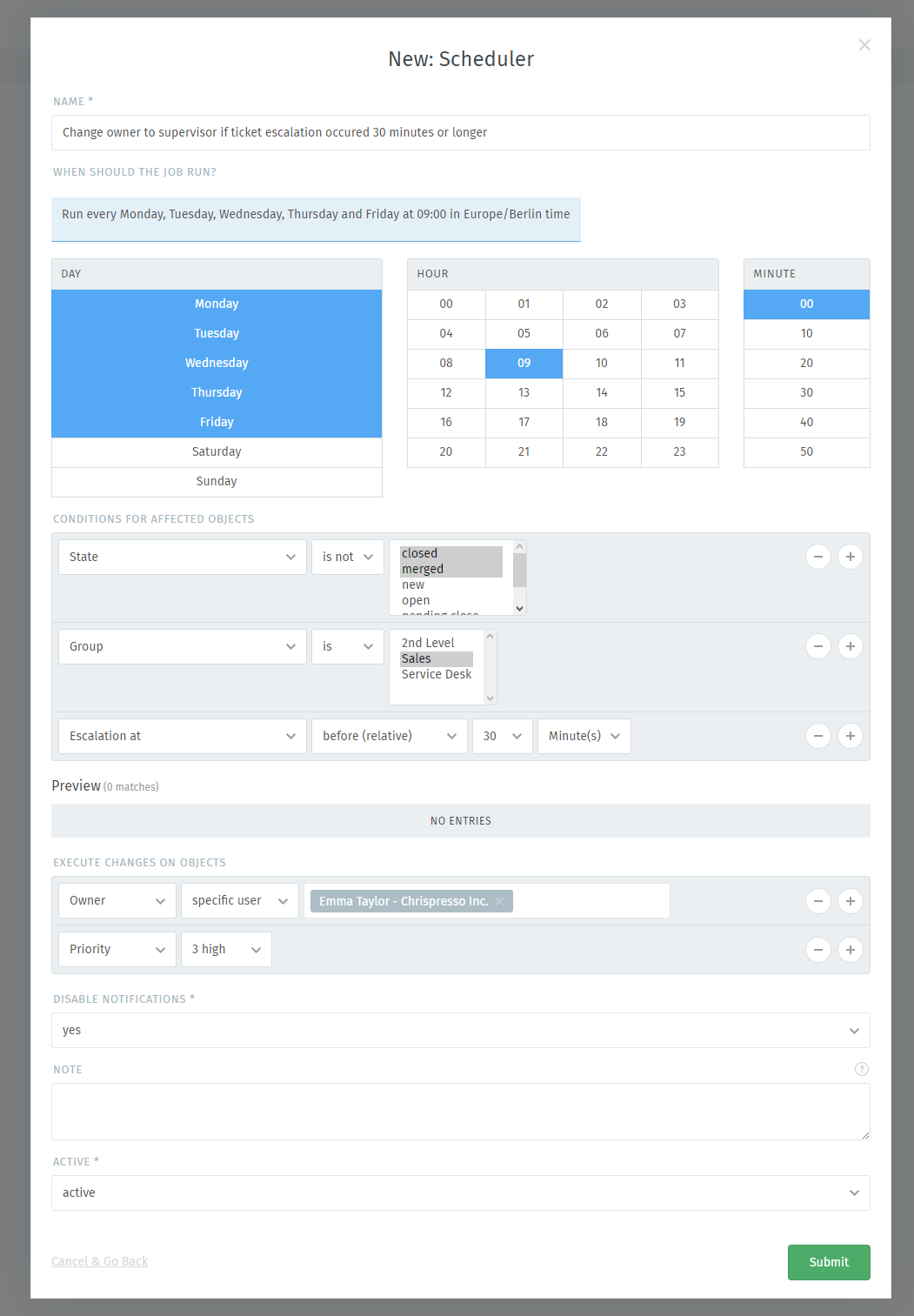

- Name
Choose a name for the scheduler.
- When should the job run?
Choose the points in time using Zammad’s timezone when the scheduler should run.
The scheduler tasks are not saving any timezone information. Thus: Scheduler tasks created prior Zammad 5.1 don’t require any change.
- Conditions for affected objects
Determine the ticket attributes (conditions) to limit on which tickets the actions configured in step 5 are to be performed.
Many condition settings in Zammad, no matter if in ticket scope or not, re-appear in several places of Zammad. For this reason we created a dedicated documentation section to reduce duplicate drag.
- Vorschau
This list previews some tickets that your conditions are matching and shows a total of how many tickets are being matched. Use this to double-check the entered conditions.
- Führt folgende Änderungen an Objekten durch
Determine the changes to be made to the ticket.
- Benachrichtigungen deaktivieren
By default, actions triggered by schedulers won’t send notifications. You can override this here by setting this to no.
- Note
You can use the note field to describe the purpose of the scheduler. This is only visible to other admins when they are editing the scheduler. It is not a way to add notes to tickets.
- Active
With this setting you can enable/disable the scheduler.
The scheduler shown in the screenshot would have the following effects:
Every workday (Monday to Friday) at 9:00 a.m. (Europe / Berlin UTC+1), all tickets which:
are not closed or merged, and
are assigned to the Sales group, and
whose escalation was 30 minutes ago
will be:
assigned to Emma, and
have their priority changed to 3 high.
As a supervisor in the Sales group, this enables Emma to intercept and process escalated tickets.
Emma will not receive notifications when the scheduler assigns her these tickets, and no note will be added to them.
