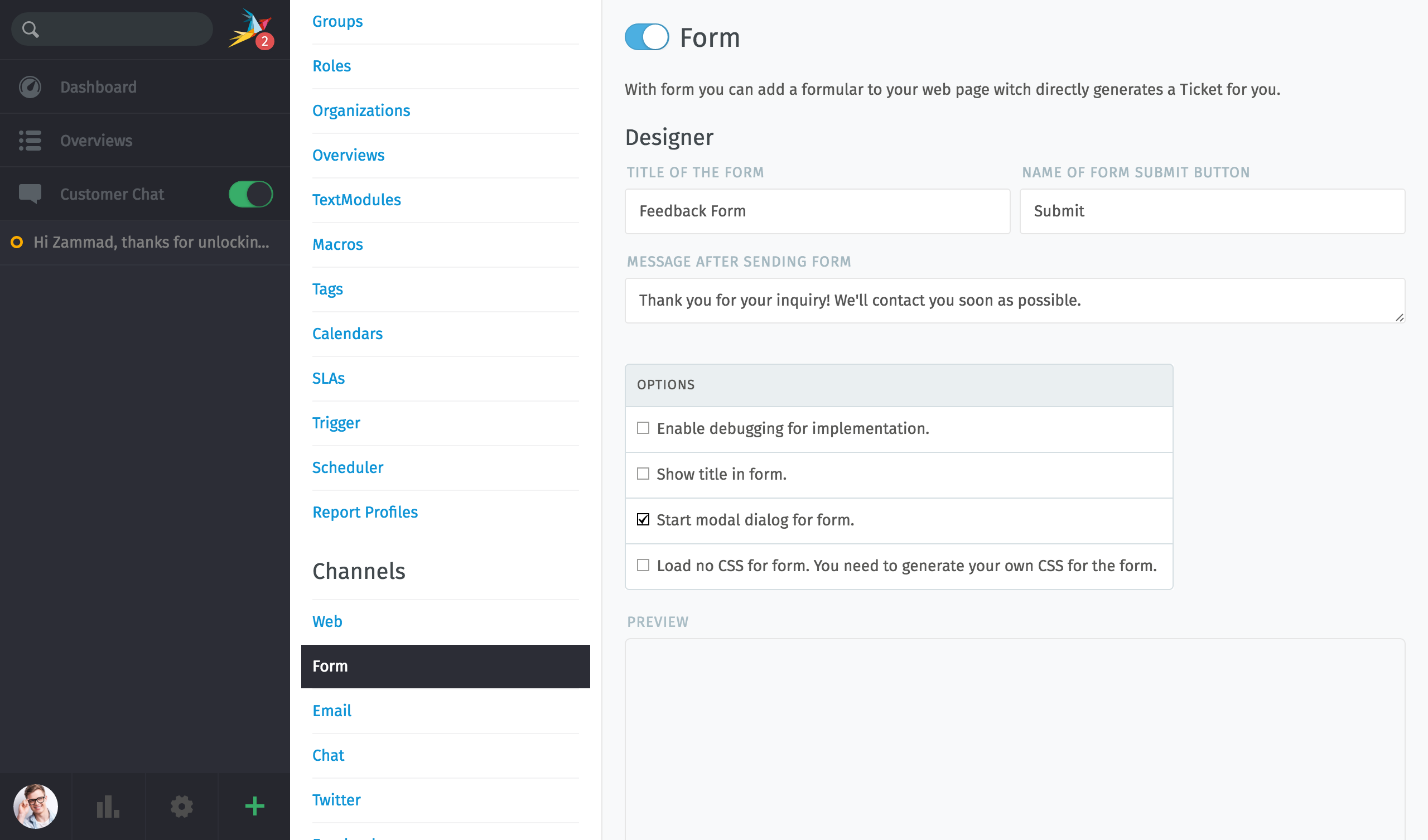

Go to “Admin -> Channels -> Form” and enable the switch for this feature. Below you can adapt your form settings.
