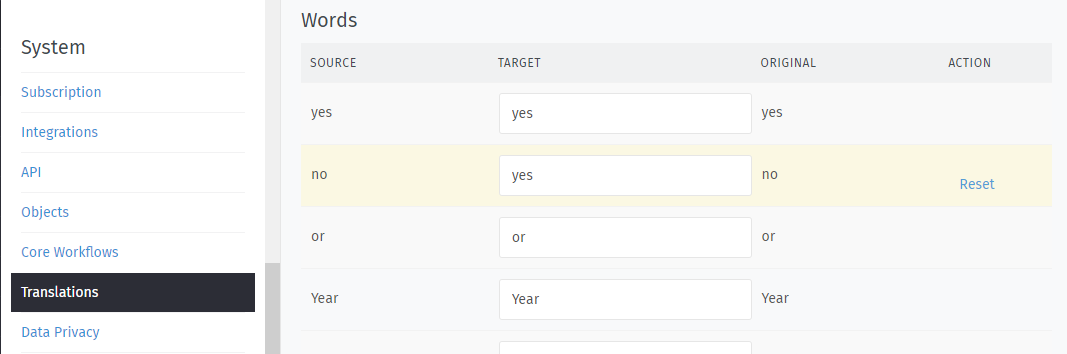

Within the translation menu, look up the string you’re searching for and update its target as designed. As soon as you leave the target input field, the change will be saved.
Such locally translated strings are slightly highlighted and come with a “Reset” action.

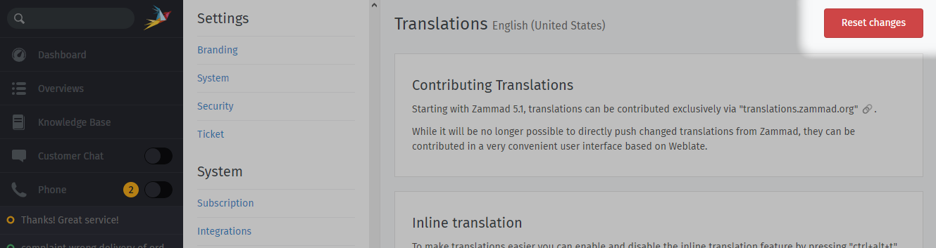

If you want to reset all translation changes on your instance, use the red “Reset” button on the upper right of the translation management.
In case you just intend to reset a specific translation, lookup the translation string and use the “reset” action.
