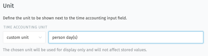

By default, agents account time as a unitless numerical input. However, it is possible to show a specific unit by configuring Unit setting, which provides several options:
- no unit
Default behavior, no unit is shown next to the time value.
- hour(s)
Shows
hour(s)as the unit next to the time value.- quarter-hour(s)
Shows
quarter-hour(s)as the unit next to the time value.- minute(s)
Shows
minute(s)as the unit next to the time value.- custom unit
Shows a custom unit that can be specified as free input.
The configurable time accounting unit is used only for display!
No numerical transformation will be applied to the values, the unit is merely used to indicate to the agents in which units their time is accounted. The original time values will be preserved.

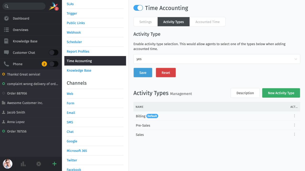

Activity Types¶
Activity Types can be used to group the different ticket time accounting entries together. For example, entries that are relevant to a “Billing” type.
When you enable the recording of the Activity Type, the agents will be able to select a type from this list.
Additionally, a column with an associated activity type will be rendered for an entry in the Activity table under the Accounted Time tab.

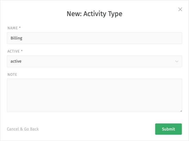

You can manage available activity types in this screen like any other Zammad object. Only active types will be available for the selection when recording new times.
Activity types can be set as default, and in that case they will be pre-selected for the agents when they are asked to account their time. It is also possible to unset default activity type, in which case no type will be pre-selected and the agents can make their choice.
