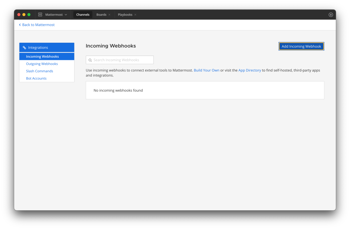

In your Mattermost top-left corner product menu, choose Integrations.
Click on Incoming Webhooks integration button.
Click on Add Incoming Webhook button.

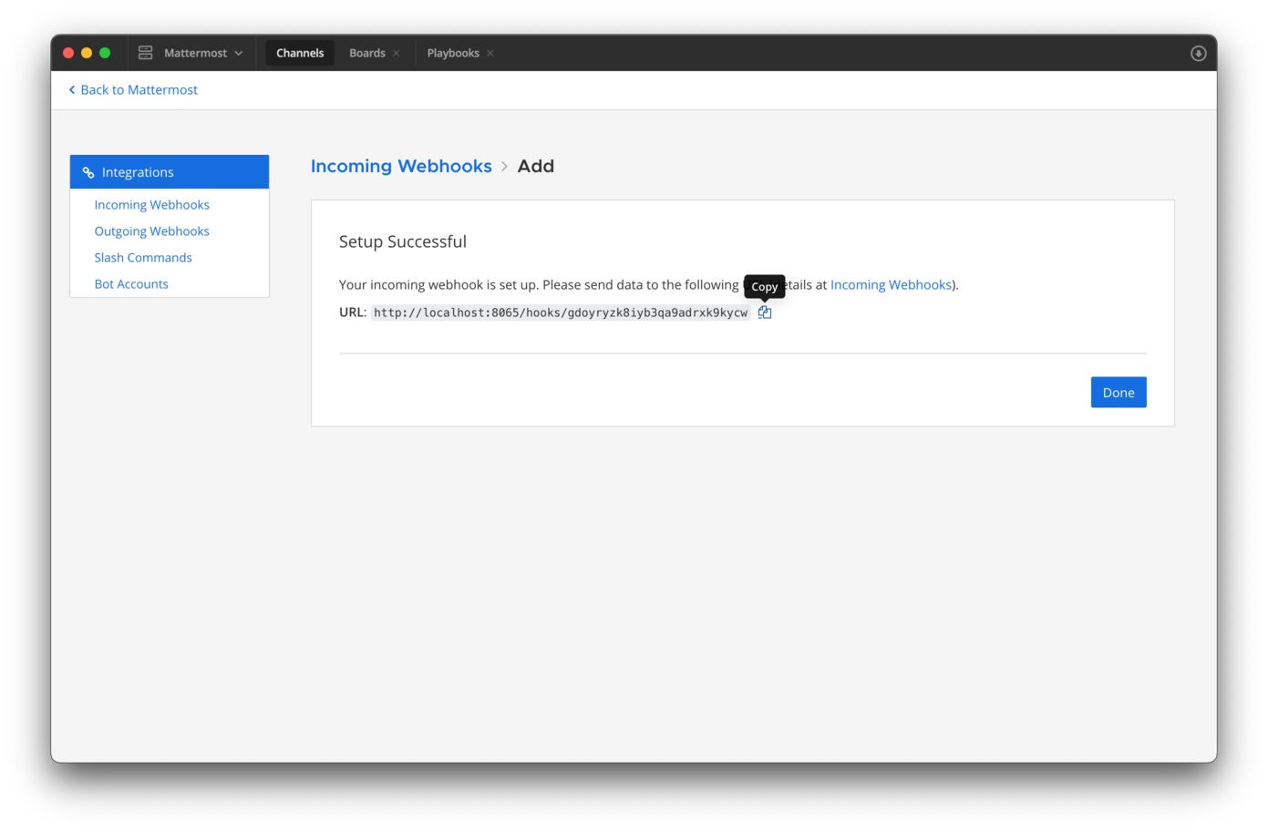

Once created, make sure to copy the webhook endpoint URL to clipboard and save it for later. You can do this in one click via the button shown right next to the field.
Finally, close the incoming webhook setup by clicking Done.

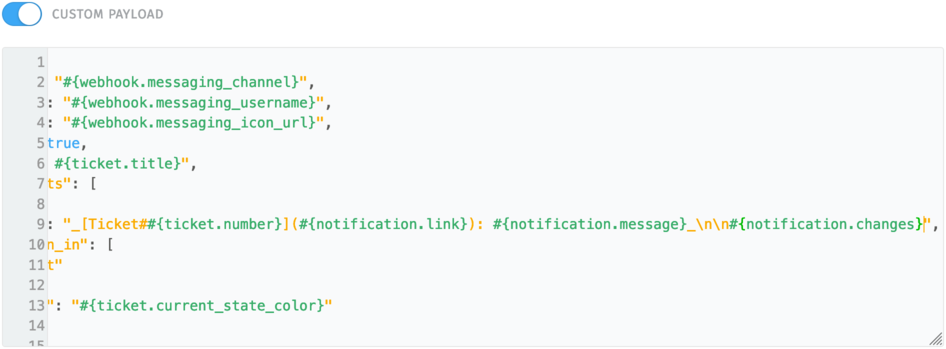

Removing Article Content from the Mattermost Notification¶
If you are concerned about leaking sensitive article content via notifications, there is a way to remove them by further customizing the webhook payload.
Find your webhook in the list on the management screen and click on it to edit it.
Switch on Custom Payload and the code editor below will be shown, pre-populated with the default payload.
Next, identify the line starting with "text": "... block in the JSON
structure.
Scroll horizontally to the end of the line and select
\n\n#{notification.body} part near the end. Be sure not to include the end
double quote with comma (",) in the rest of the line, since the new payload
must remain a valid JSON value.
Then, simply delete the selected code.
Finally, click on Submit to save your webhook changes.
On the next invocation of the webhook, the notification will not include content of the last article.
