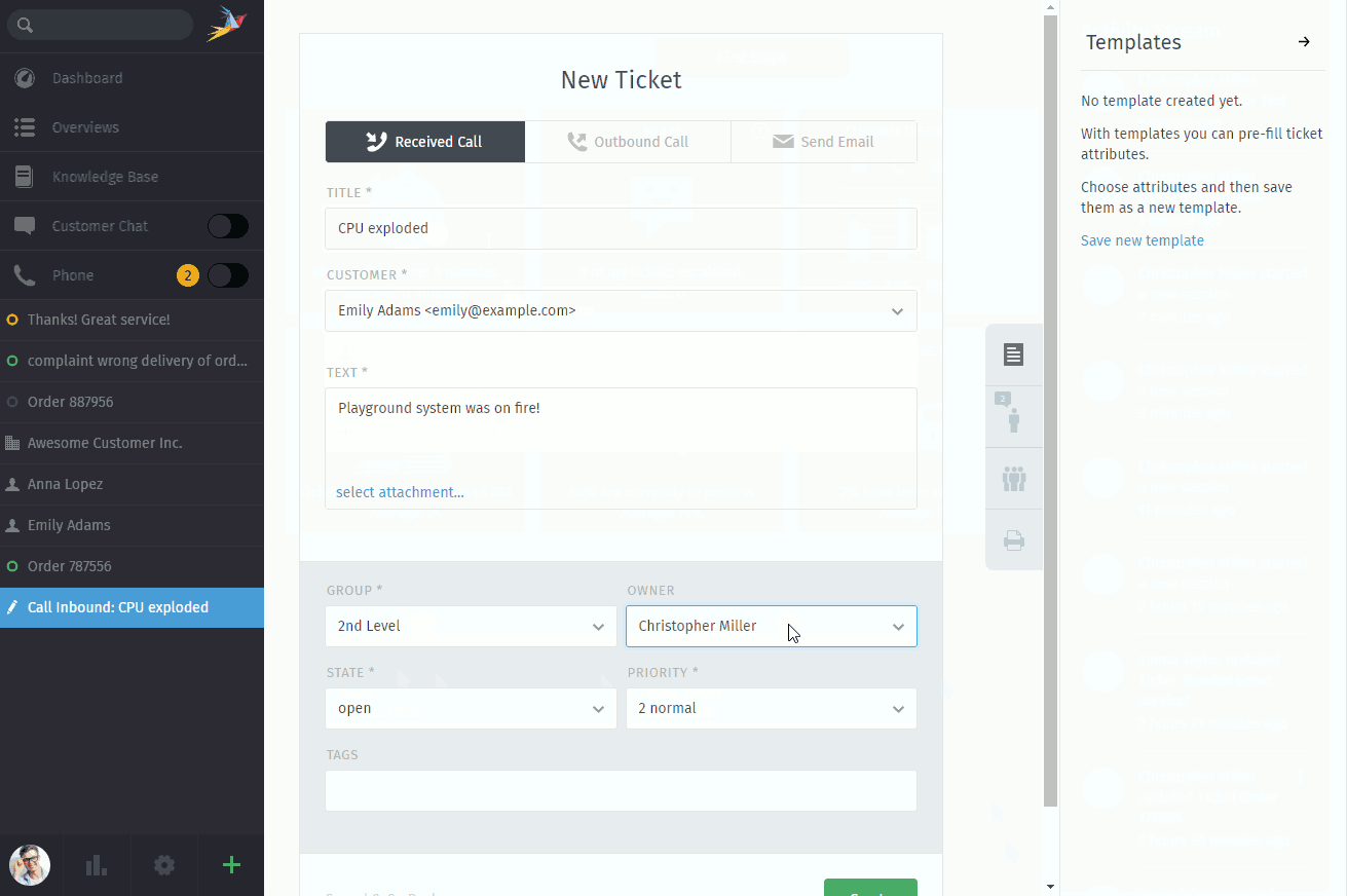

The i-doit integration will appear under a new 🖨 tab in the ticket pane.¶
i-doit integration puts a new tab in Zammad’s ticket pane where you can add links to existing i-doit devices for easy reference. (See our user documentation to learn how it works in practice).

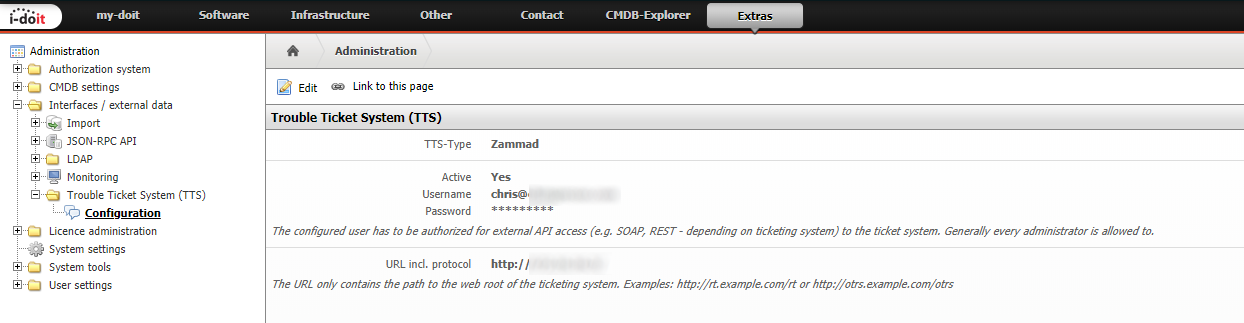

Enable this integration in the i-doit admin panel under Interfaces / external data > Trouble Ticket System (TTS) > Configuration:
- TTS-Type
Zammad- Username / Password
Login credentials for a Zammad agent.
This agent must have read permission for all groups that plan on using the i-doit integration.
You may even wish to create a dedicated agent account just for this integration (otherwise, if the agent ever changes her password, you will have to remember to update it here).
- URL incl. protocol
https://your.zammad.domain
