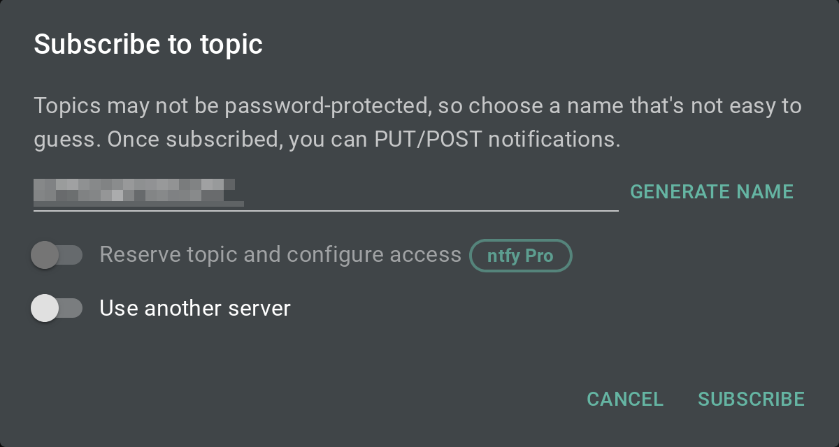

Step 1 - Setup Ntfy Topic
Go to ntfy and create a new topic by using the Subscribe to topic button. Either configure access to this topic (in case you are a ntfy Pro user) or choose a random topic.
Subscribe to topic dialog from ntfy
Once created, make sure to copy your topic name to clipboard and save it for later.
If you want to password protect your channel, you have to use basic auth in your webhook with username and password. See ntfy documentation for more information.

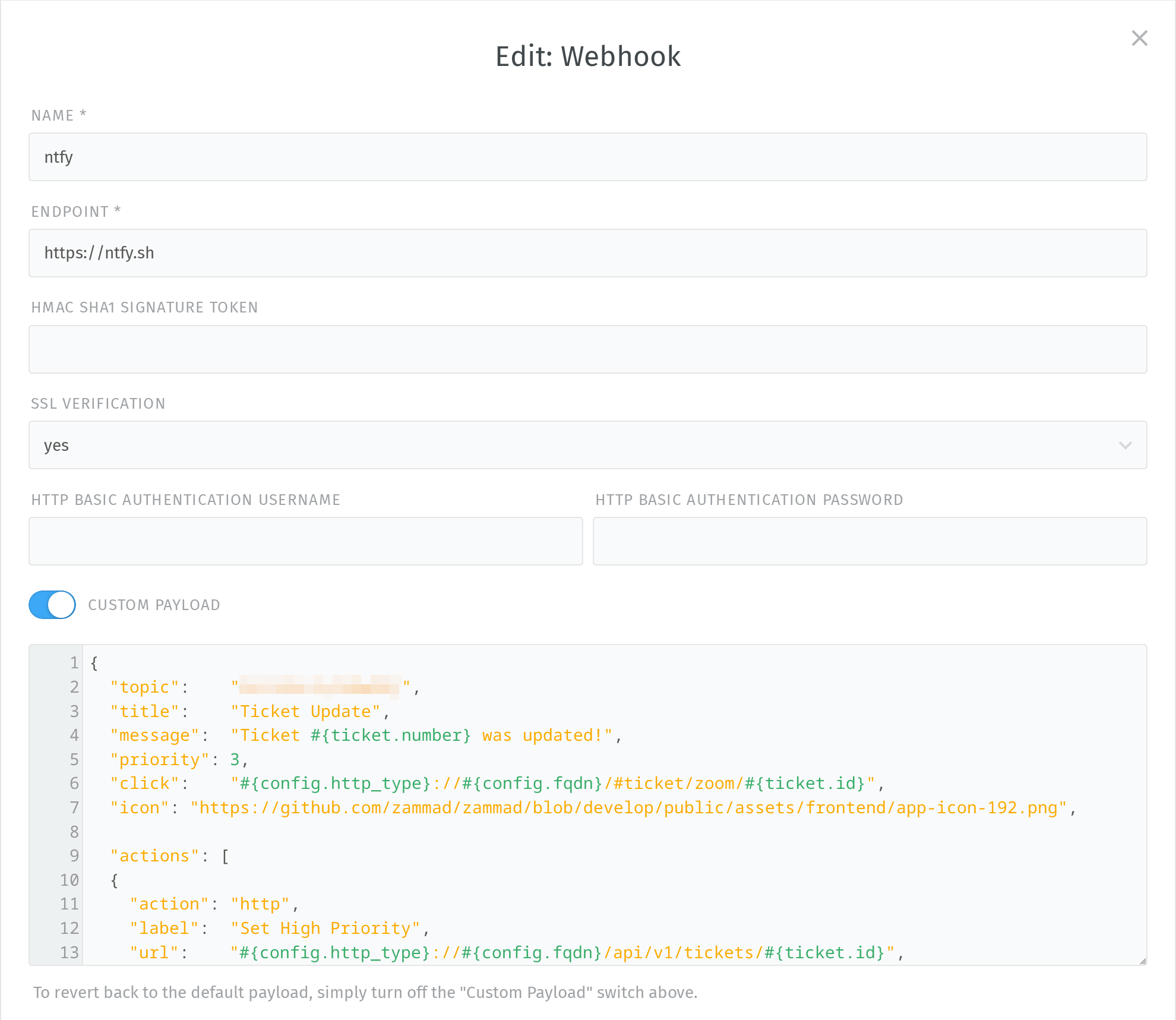

Step 2 - Add a New Webhook with Custom Payload
Go to Webhook management screen in your Zammad instance and click on the New Webhook button. Activate the “Custom Payload” toggle and add your information like in the example.
Depending on the features you want to use and your ntfy plan, it might be required to provide HTTP Basic Authentication Username as well as the appropriate password.
Webhook creation / edit dialog in Zammad with ntfy example
You can find the example payload below. Important attributes are:

   "topic":    "{insert your topic here}",
   "title":    "Ticket Update",
   "message":  "Ticket #{ticket.number} was updated!",
   "priority": 3,
   "click":    "#{config.http_type}://#{config.fqdn}/#ticket/zoom/#{ticket.id}",
   "icon": "URL to an icon in png or jpg.",
   "actions": [
         "action": "http",
         "label": "Set High Priority",
         "url": "#{config.http_type}://#{config.fqdn}/api/v1/tickets/#{ticket.id}",
         "method": "PUT",
         "headers":
               "Authorization": "Bearer {your bearer token from Zammad}",
               "Content-Type":  "application/json"
         "body": "{\"priority_id\": 3}"
Finally, click on Submit.

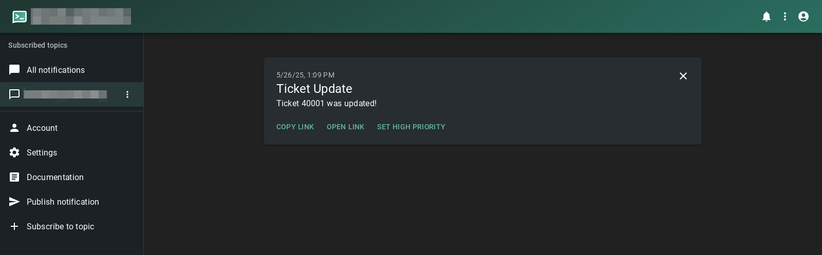

Sample NTFY Channel Notification
From now on, a notification will be pushed to ntfy and all subscribed devices. The notification contains the link to the ticket, an image and action buttons, depending on what you configured.
Sample notification in the ntfy web dashboard
