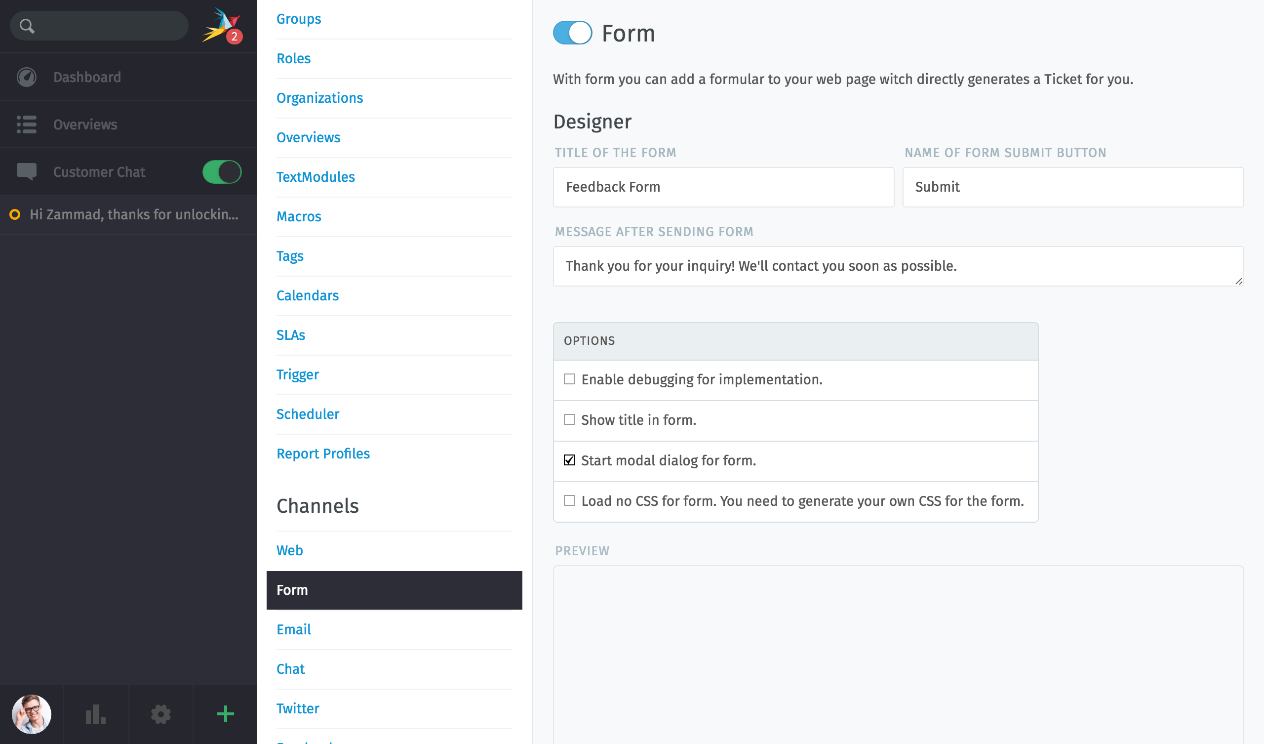

Go to „Admin -> Channels -> Form“ and enable the switch for this feature. Below you can adapt your form settings.

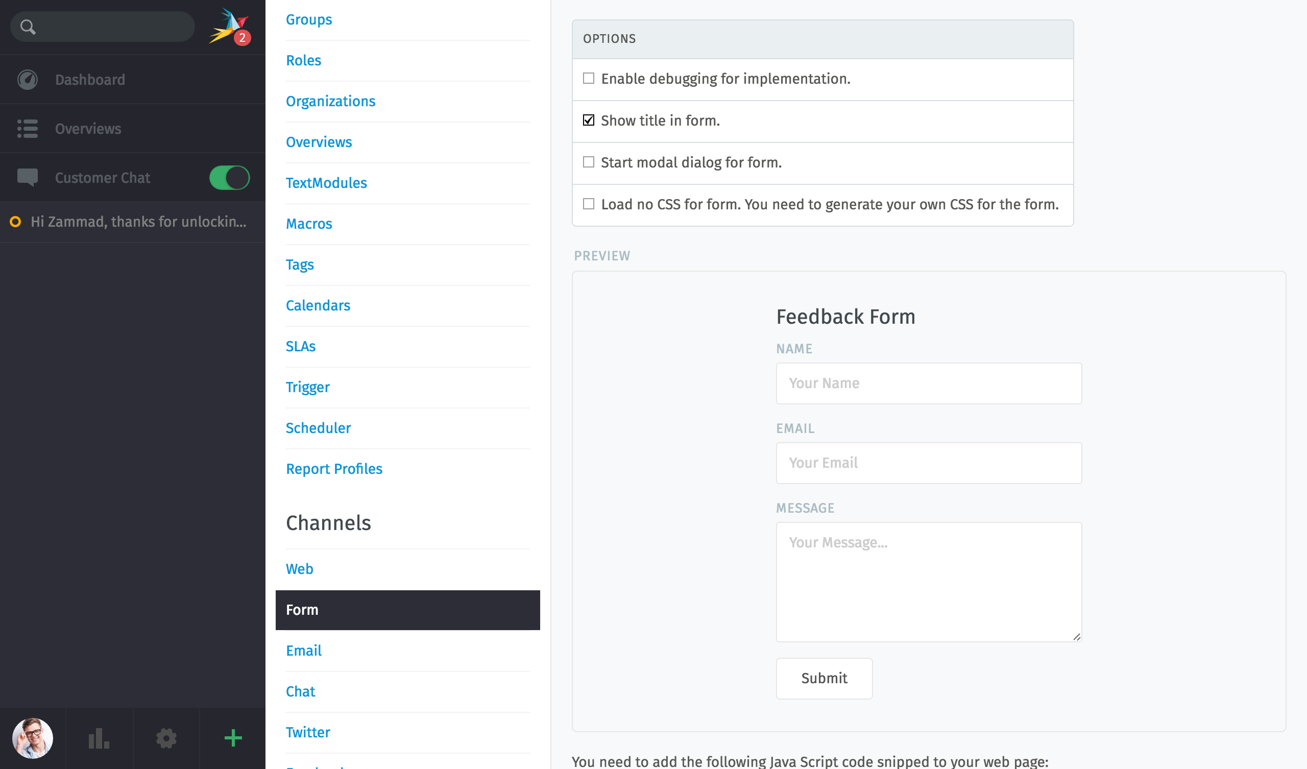

In preview mode you can test if the form fits your needs (e. g. if it opens as modal dialog or if it’s shown inline on the website)
test it in preview mode

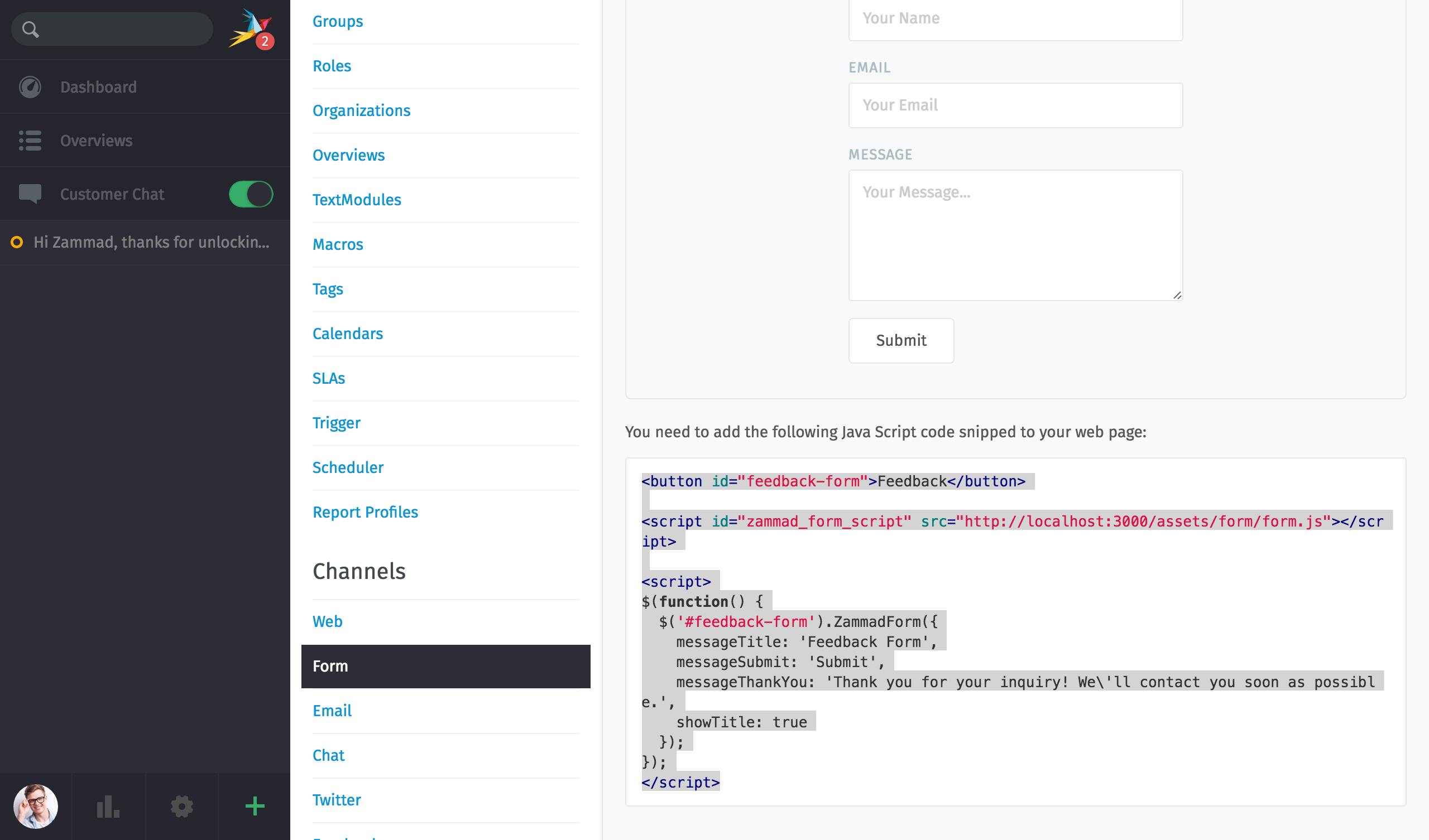

Just copy the JavaScript snippet and paste it into your website. That’s all. Just 2 minutes.
copy the JavaScript snippet and paste it into your website - done

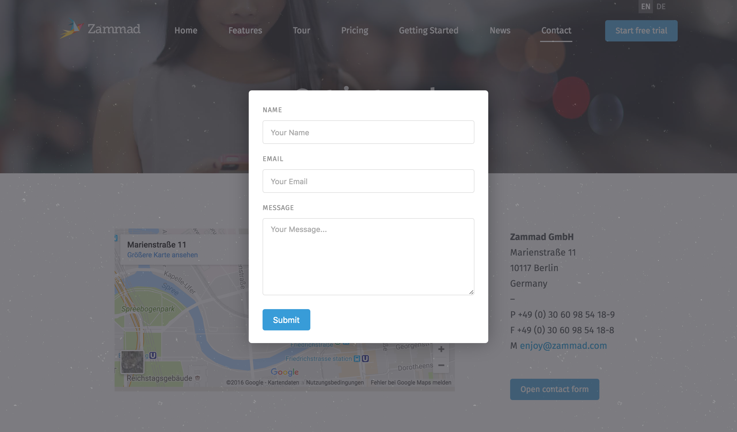

Finally, the forms will look as follows:
example form as modal dialog
