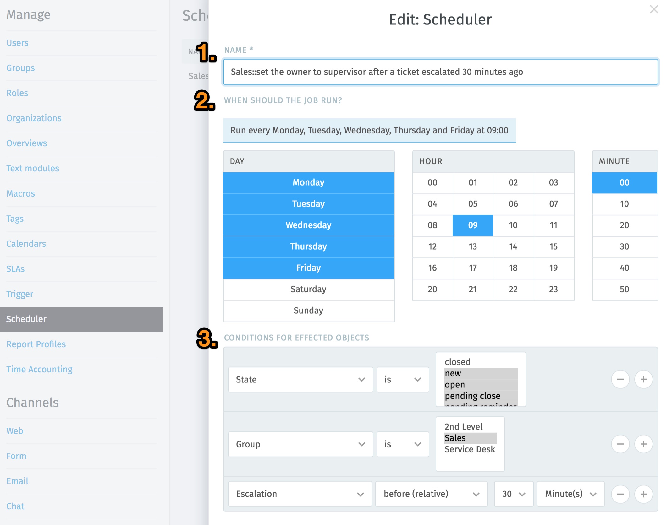

Name: choose a name for the scheduler.
When should the job run: choose the points in time using UTC timezone when the scheduler should run.
Conditions for affected objects: determine the ticket attributes (conditions) to limit on which tickets the actions configured in step 5 are to be performed.

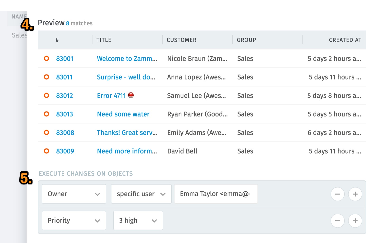

Preview: this list previews some tickets that your conditions are matching and shows a total of how many tickets are being matched. Use this to double-check the entered conditions.
Execute changes on objects: determine the changes to be made to the ticket.

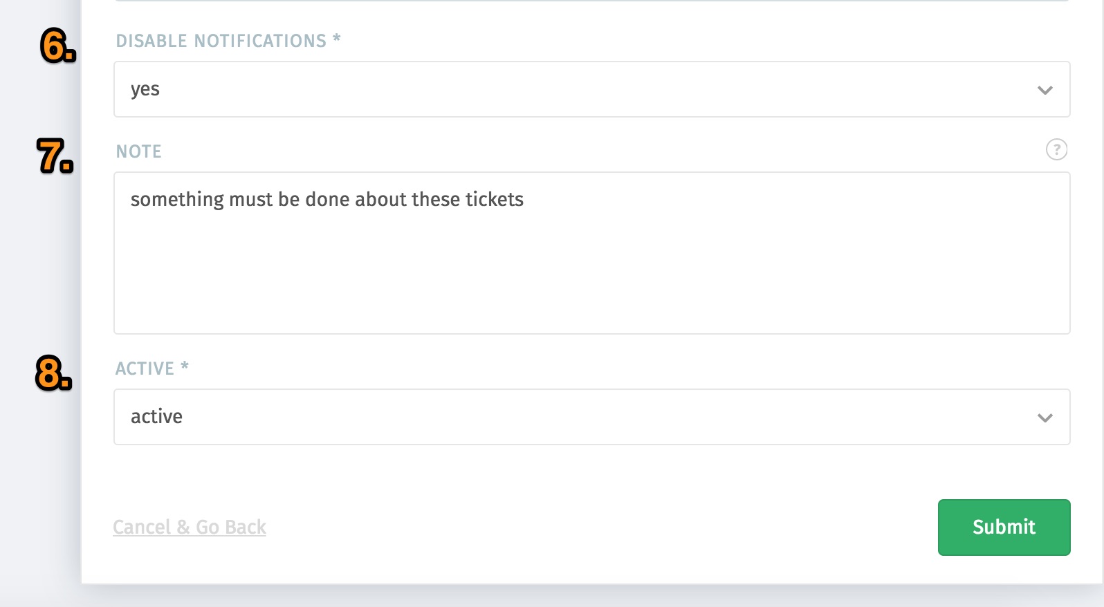

Disable notifications: by default, actions triggered by schedulers won’t send notifications. You can override this here by setting this to no.
Note: you can use the note field to describe the purpose of the scheduler. This is only visible to other admins when they are editing the scheduler. It is not a way to add notes to tickets.
Active: with this setting you can enable/disable the scheduler.
The scheduler shown in the screenshot would have the following effects:
Every workday (Monday to Friday) at 9:00 a.m. (UTC), all tickets which:
are not closed and
are assigned to the Sales group and
whose escalation was 30 minutes ago
will be:
assigned to Emma and
have their priority changed to 3 high.

Emma will not receive notifications when the scheduler assigns her these tickets, and no note will be added to them.
