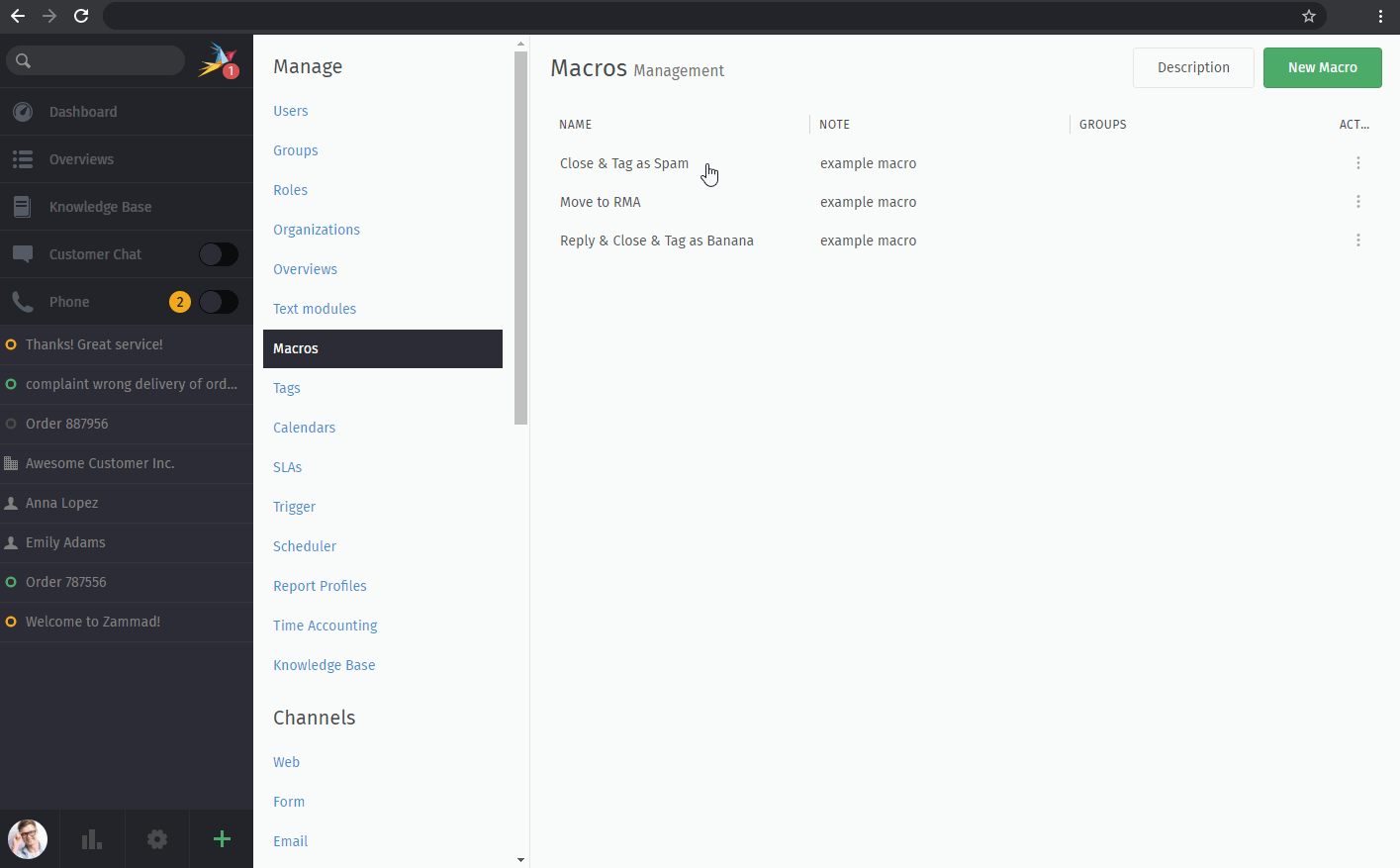

Learn by example¶
To get you up and running quickly, here are some examples of the kinds of one-click actions you can set up using macros.
If they don’t make sense to you, don’t worry—just skip ahead to Wie funktionieren sie? to learn about all the options in detail, then come back here to see them in action.
