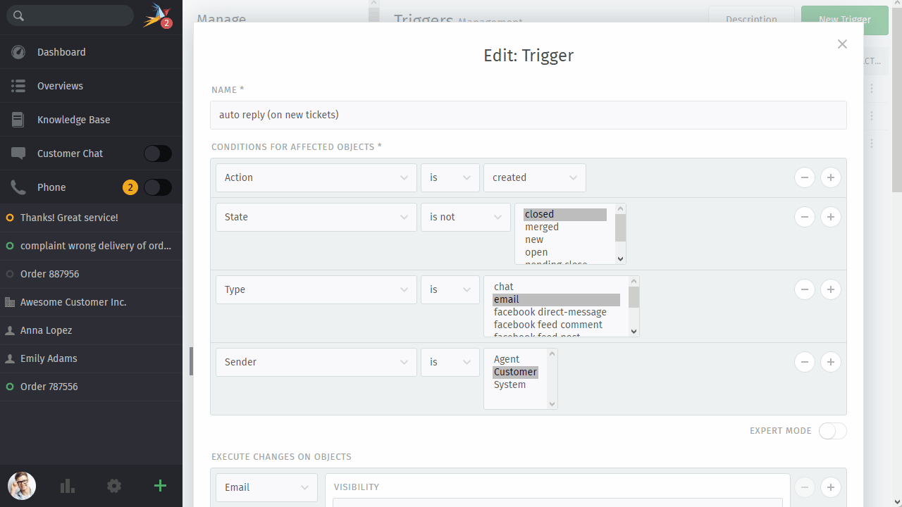

You can enable or disable expert mode in any supported condition screen. To do so, simply use the expert mode button on the lower right below the conditions for affected objects area.
Screencast showing expert mode being enabled in trigger dialog

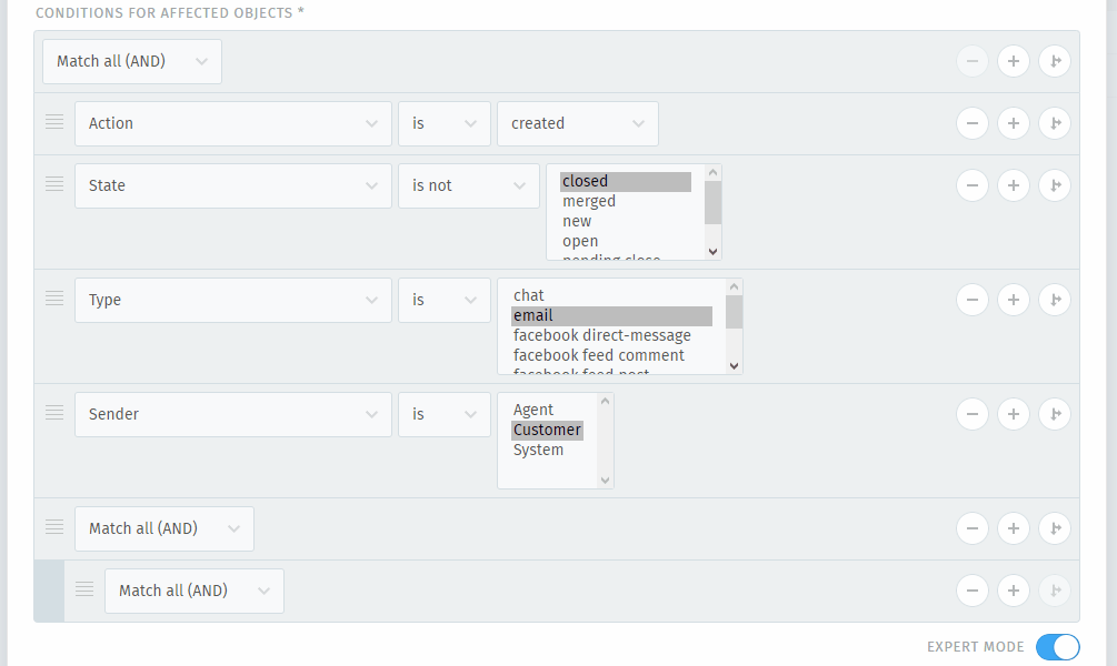

Adding conditions and logic blocks
By using the Icon for adding a new subclause block icon you can add as many logic blocks as you need. New blocks will be added below the object you’re using the Icon for adding a new subclause block icon on.
The level will be automatically set to a lower level than the object you’re using it on.
Screencast showing new logic blocks being added

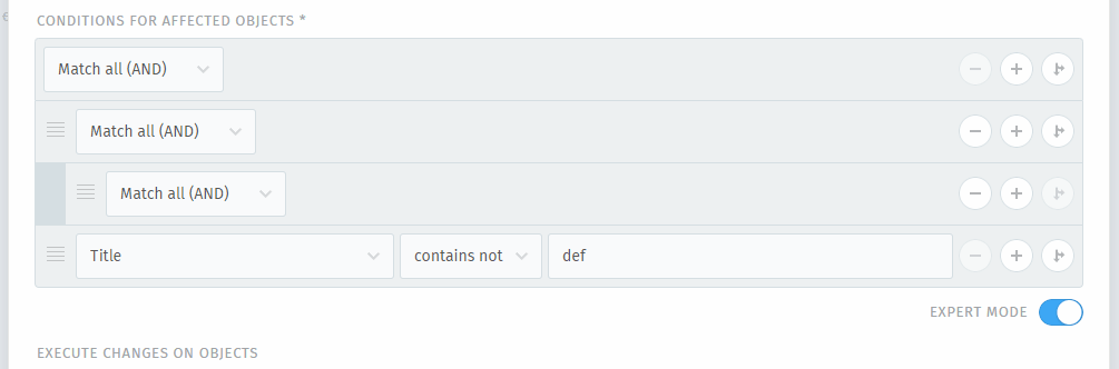

The same behavior also applies to conditions within logic blocks!
Screencast showing new conditions being added to logic blocks
