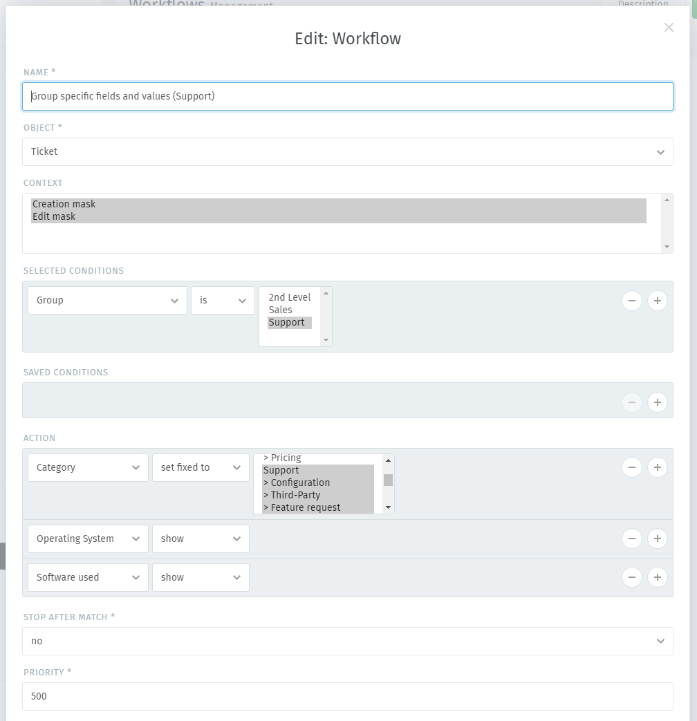

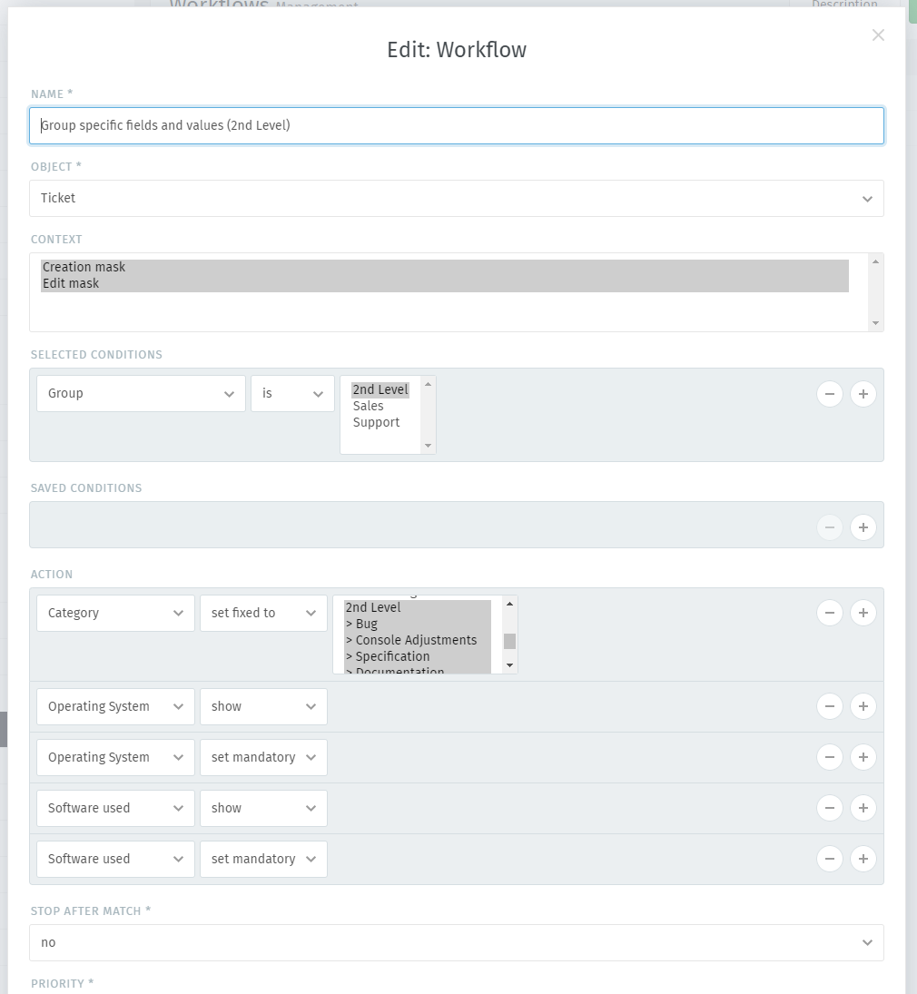

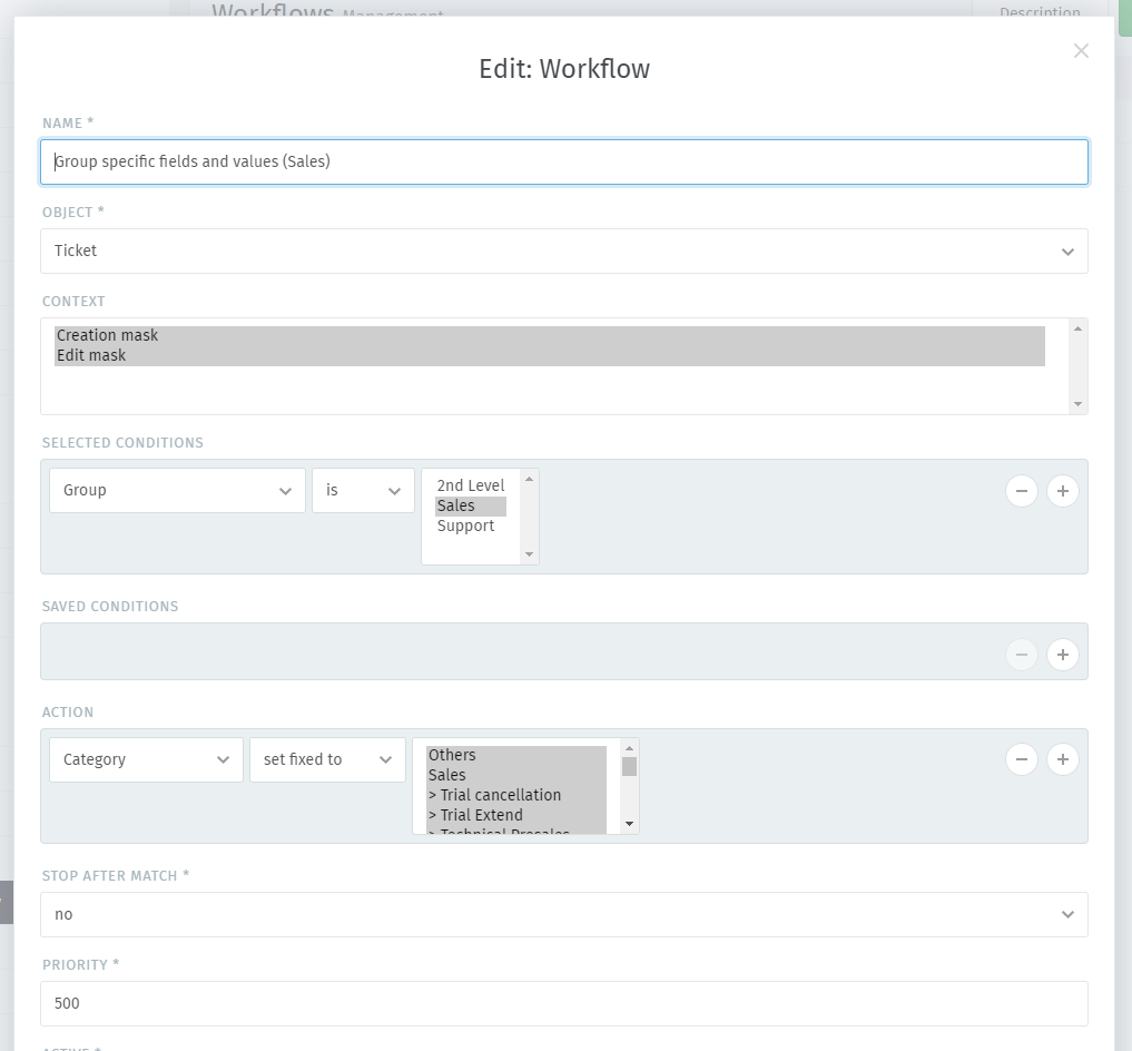

- Group specific values and fields
This workflow set depends on the category field. It reduces the available set of values based on the group selected.
This reduces the category options to
2nd Level/*,Internal/*andOthers. It also sets further required fields to mandatory and visible.This reduces the category options to
Support/*,Internal/*andOthers. It also sets further required fields to visible.- The Result

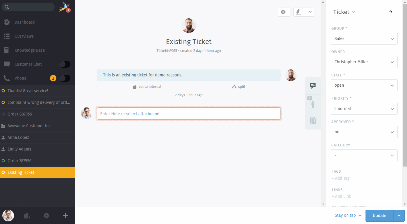

This is what the agent would experience with the above workflows in place.

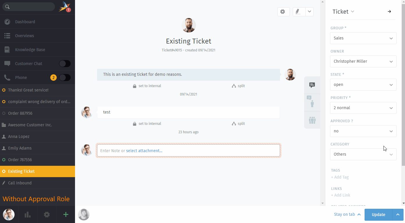

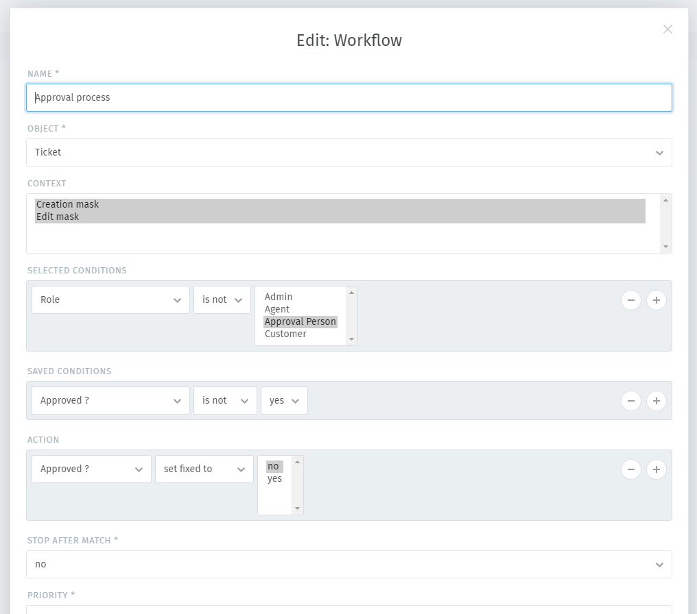

- Approval process
In this case
approvedis visible to agents by default. For this workflow, an additional roleApproval personis required (no further permissions).Tipp
This workflow may work best in combination with a trigger but technically, this is not required.
Select fields may be a better approach because they allow more values than just a simple
trueorfalse.- The result

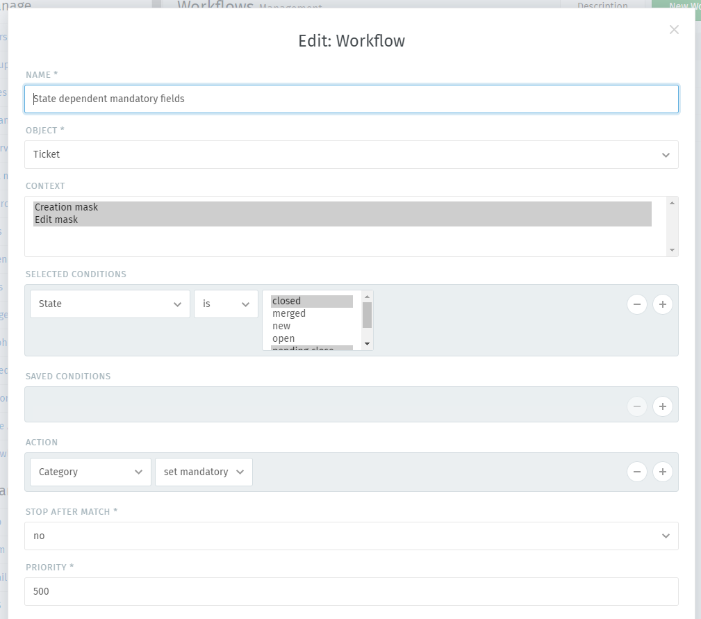

- State dependent mandatory fields
This workflow sets
Categoryto mandatory if the agent wants to set the statesclosedorpending closeto enforce categorization.- The result
