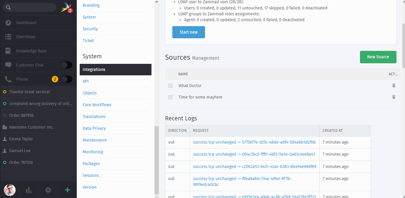

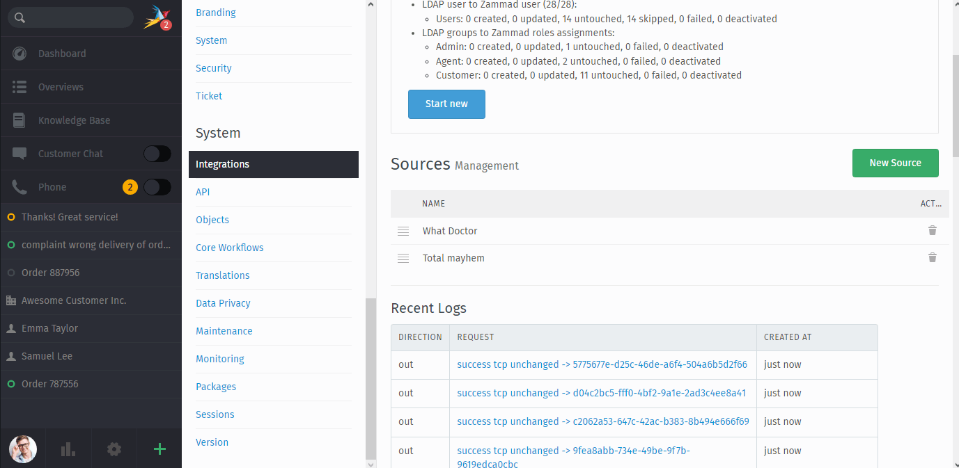

- Re-arrange LDAP source’s order
You can change the synchronization order for each source at any time. Zammad will synchronize the sources from top to bottom.

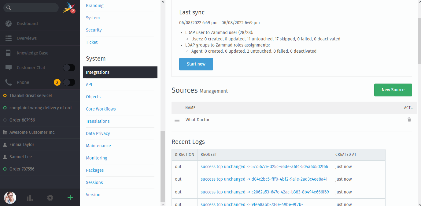

- Remove a source
If you no longer need the a LDAP source or simply want to start over, you can remove them at any time. This will not remove synchronized users, data synchronized or permissions.
