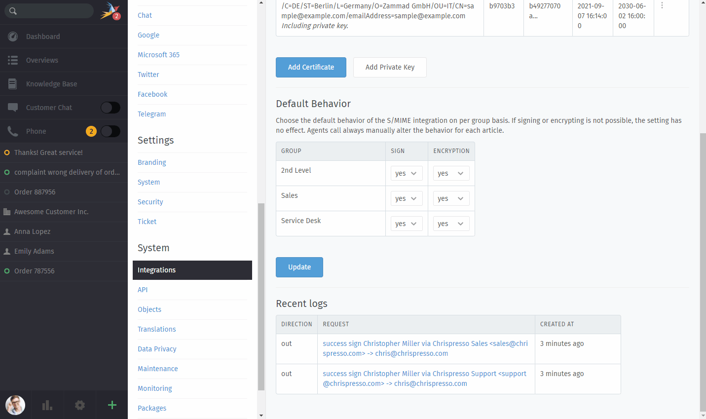

All of the system’s latest S/MIME activity is displayed in the Recent Logs section.
Logs report the status and details of all mail, both incoming and outgoing, that used signing/verification or encryption/decryption.¶
