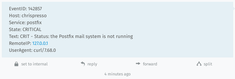

When a notification is received, Zammad creates a new article containing the details of the event that triggered it:
These details come from the fields listed below,
which correspond to parameters provided by Checkmk ($NOTIFY_*).

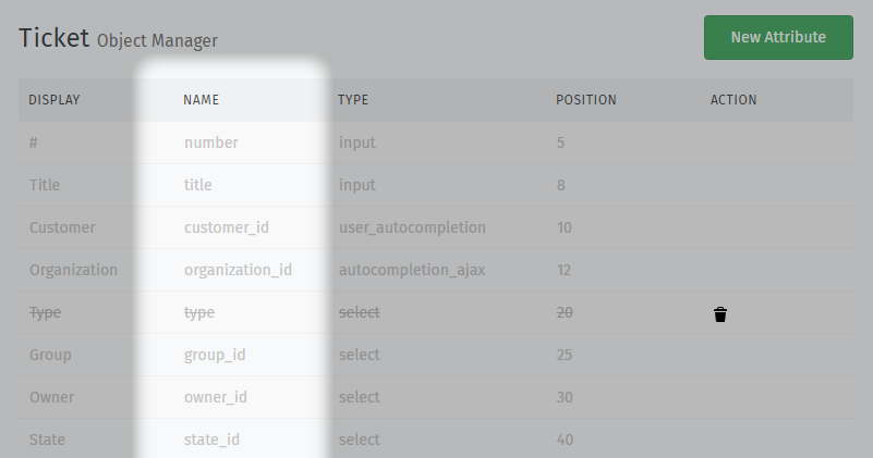

Find a complete list of ticket attributes in the Object Manager.¶
Ticket attributes are entirely optional, and can be used to customize the tickets that Checkmk creates. (Note that these attributes will be ignored if a new event belongs to an existing ticket.)

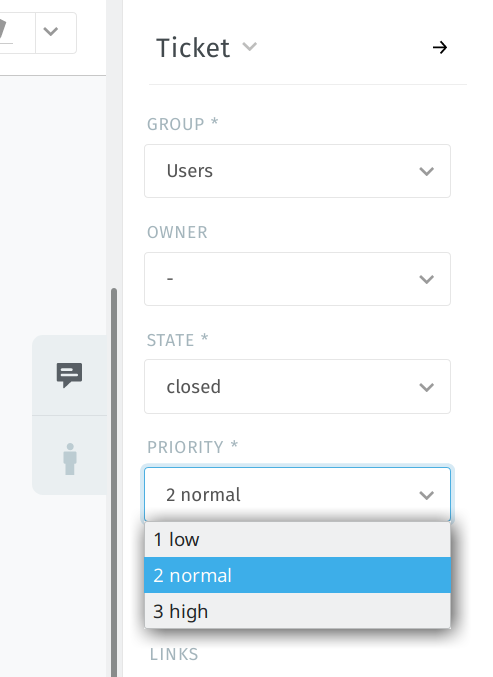

- group & priority
Refer to the dropdown menus in the ticket pane:
-F "group=Users" -F "priority=3 high"

To set any other attributes, it helps to know your way around the rails console. Valid values are those that you can set with a string:
# valid >> Ticket.first.update(note: "You're gonna need a bigger boat") => true >> Ticket.first.note => "You're gonna need a bigger boat" >> Ticket::State.find_by(name: "open").id => 2 >> Ticket.first.update(state_id: 2) => true >> Ticket.first.state.name => "open" # invalid >> Ticket.first.update(preferences: "I'm a Checkmk ticket!") => true >> Ticket.first.preferences => {}
These values can then be passed directly to the API:
-F "note=You're gonna need a bigger boat" -F "state_id=2"
