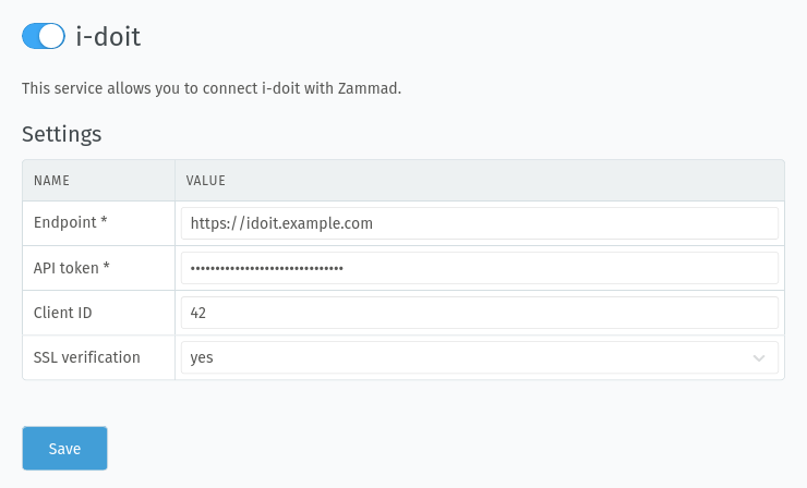

To set it up, enable the integration in the Zammad admin panel under System > Integrations > i-doit:
- Endpoint
The root URL of your i-doit installation.

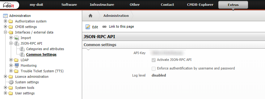

- API token
Found in the i-doit admin panel under Interfaces / external data > JSON-RPC API > Common Settings.
- Client ID
A unique name to identify Zammad within i-doit.
(Zammad does not require you to enter a value here, but i-doit might!)
- SSL verification
Here you can decide if the certificate of your i-doit system has to be verified or not. In case you are using custom certificates, please have a look at how to add them to Zammad.

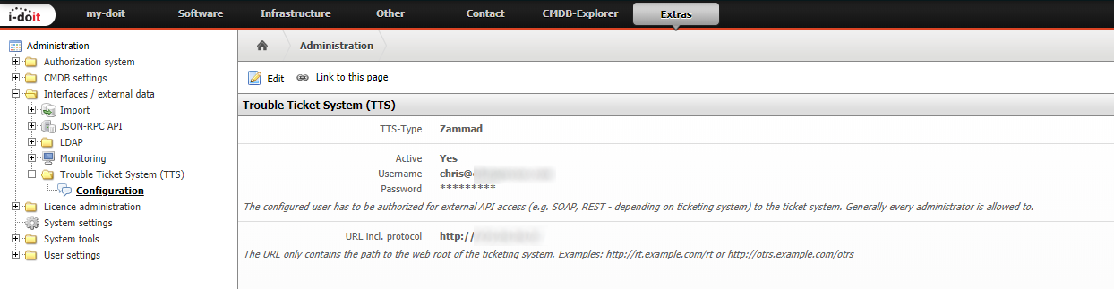

Enable this integration in the i-doit admin panel under Interfaces / external data > Trouble Ticket System (TTS) > Configuration:
- TTS-Type
Zammad- Username / Password
Login credentials for a Zammad agent.
This agent must have read permission for all groups that plan on using the i-doit integration.
You may even wish to create a dedicated agent account just for this integration (otherwise, if the agent ever changes her password, you will have to remember to update it here).
- URL incl. protocol
https://your.zammad.domain
