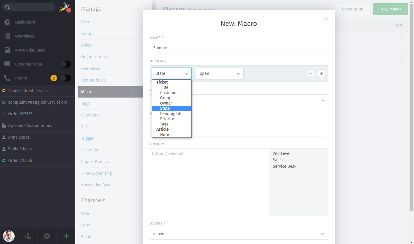

Screenshot showing different possible actions for macros.
Actions
You can create actions to:
  • set ticket attributes (priority, state, group, etc.)
  • add new notes to a ticket
There are no actions for:
  • sending a reply to the customer
Unlike triggers, the scheduler, and text modules, macro actions do not support the use of Variables.
If the ticket is missing a required attribute and the macro doesn’t set it, then no actions will be applied.

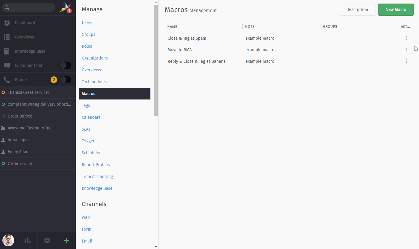

You can delete or even clone existing macros in the Admin Panel under Manage > Macros.
Screencast showing the creation of a new macro via cloning and its removal
When cloning a macro, you must click “Submit” for the duplicate to be created.
