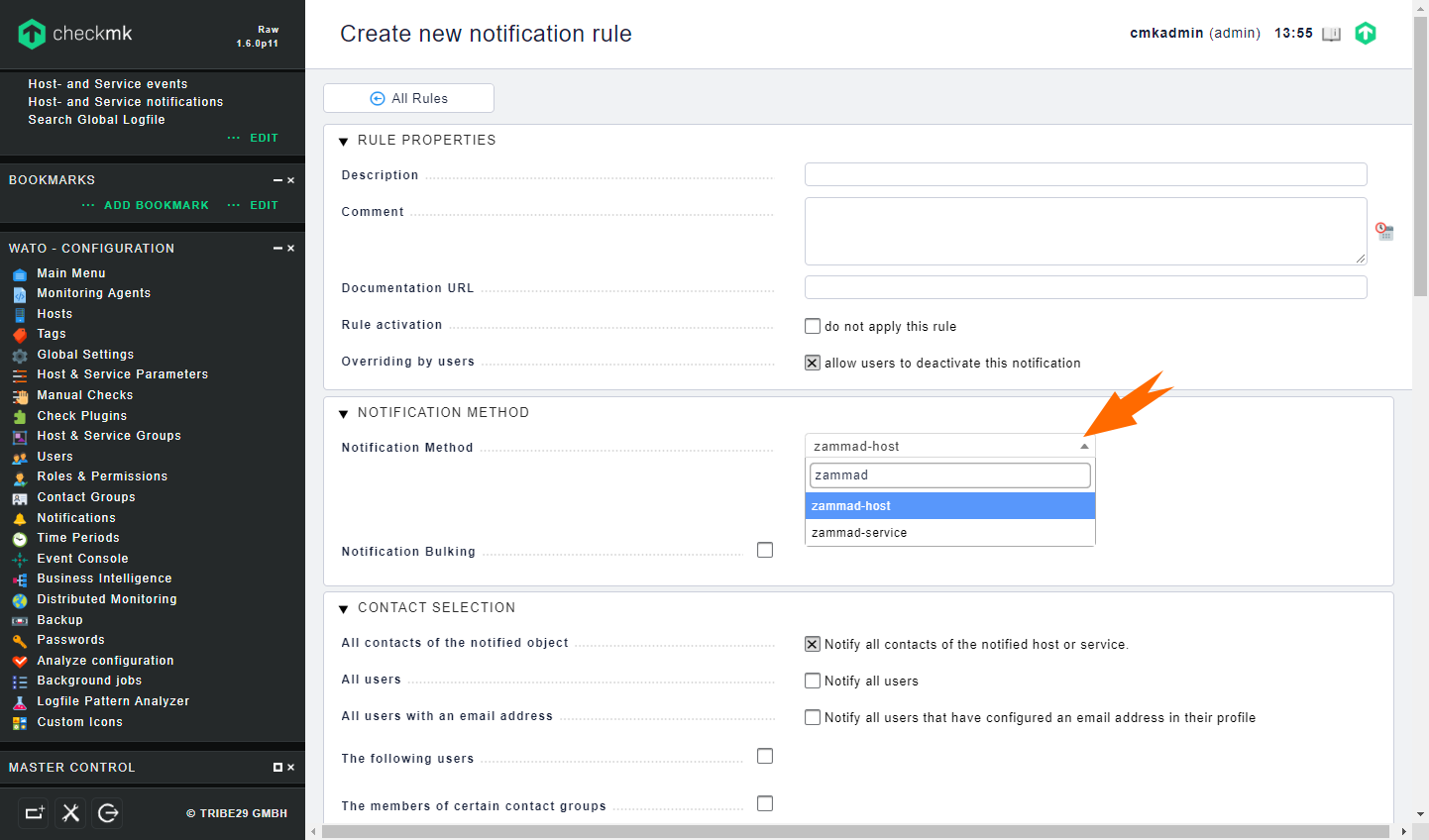

That means that “setting up Checkmk integration” is simply a matter of adding configuration to your Checkmk site: telling it when to send these messages and what to say. To do that, you’ll need to create a new notification rule (see Checkmk’s official docs for help with that).
As part of this new rule, you’ll have to choose a notification method (i.e., a script to execute whenever the rule is triggered). This script will be written by you (samples below), and contain the logic for sending API/email messages to Zammad:
Find your custom scripts in the Checkmk WATO under Notifications > New Rule > Notification Method.¶
Once you’re done setting up your new rule, you’re all set! New tickets should start coming in and auto-updating any time your rule is triggered.
