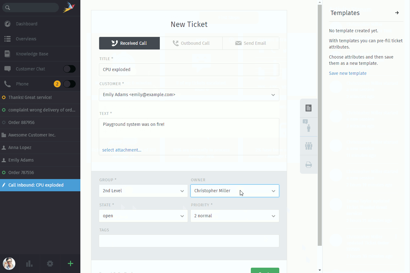

The i-doit integration will appear under a new 🖨 tab in the ticket pane.¶
i-doit integration puts a new tab in Zammad’s ticket pane where you can add links to existing i-doit devices for easy reference. (See our user documentation to learn how it works in practice).

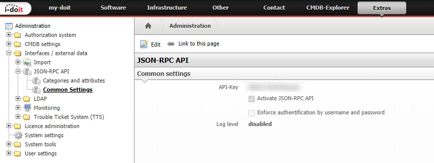

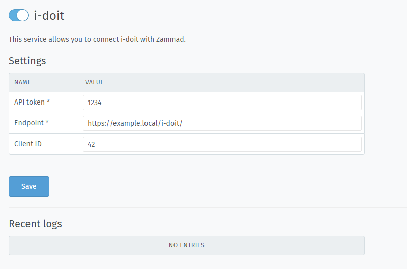

To set it up, enable the integration in the Zammad admin panel under System > Integrations > i-doit:
- API token*
Found in the i-doit admin panel under Interfaces / external data > JSON-RPC API > Common Settings.
- Endpoint*
The root URL of your i-doit installation.
- Client ID
A unique name to identify Zammad within i-doit.
(Zammad does not require you to enter a value here, but i-doit might!)

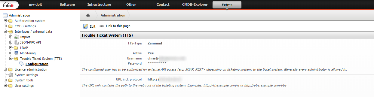

Enable this integration in the i-doit admin panel under Interfaces / external data > Trouble Ticket System (TTS) > Configuration:
- TTS-Type
Zammad- Username / Password
Login credentials for a Zammad agent.
This agent must have read permission for all groups that plan on using the i-doit integration.
You may even wish to create a dedicated agent account just for this integration. (Otherwise, if the agent ever changes her password, you will have to remember to update it here.)
- URL incl. protocol
https://your.zammad.domain
