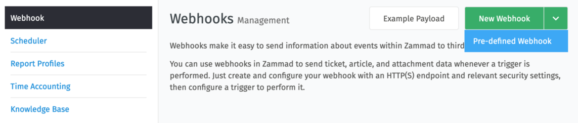

To add a new regular webhook, use the big green New Webhook button.
For a pre-defined webhook, click on the arrow button to the right and choose Pre-defined Webhook from the dropdown menu.
Next, select the pre-defined webhook you want and click Next.

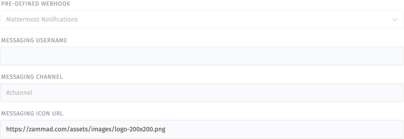

- Pre-defined Webhook
This field is only available for pre-defined webhooks!
This field is always disabled in the UI and serves only as a reference to a pre-defined webhook. It is not possible to change it for existing webhooks.
Depending on the pre-defined webhook type, additional fields may be rendered below this one. They can be used for additional customization of the webhook behavior.

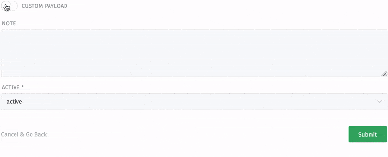

- Custom Payload
Defaults to off - webhook will always send Default JSON Payload to the target endpoint.
When switched on, a code editor will be shown below, where you can configure custom payload for your webhook in JSON format. To insert supported Variables use
::or#{shortcuts for autocomplete.![]()
Custom payload must be valid JSON syntax! Code editor will inform you via automated hints if there is an issue with the code. Also, it will not be possible to save an invalid JSON structure.
Pre-defined webhooks will always provide an initial custom payload, specific for the associated service.
