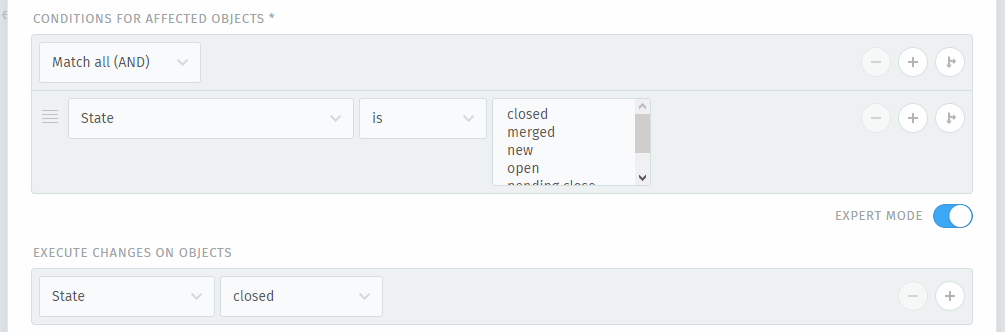

Switching to Expert mode¶

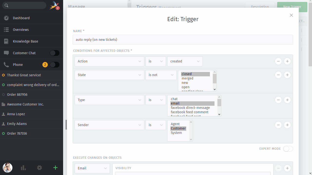

You can enable or disable expert mode in any supported condition screen. To do so, simply use the expert mode button on the lower right below the conditions for affected objects area.
Logic block conditions¶
Zammad’s condition expert mode allows you to use logic blocks. These blocks enable you to have one or several sets of conditions that have to match your requirement. These blocks allow matching as and / or and no match.
- Match all (AND)
All conditions in this block will be matched with “AND”. This requires all conditions to be met in order to be matched positive.
- Match any (OR)
Any condition in this block will be matched with “OR”. This requires one condition to be met in order to be matched positive.
- Match none (NOT)
All conditions in this block will be matched with “AND”. To be matched positive, no or any condition may match - but not all together.

Adding conditions and logic blocks¶
By using the
icon you can add as many logic blocks as you need.
New blocks will be added below the object you’re using the
icon on.
The level will be automatically set to a lower level than the object you’re using it on.
The same behavior also applies to conditions within logic blocks!
Note that removing condition blocks removes all blocks and conditions with it!
