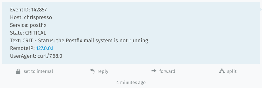

When a notification is received, Zammad creates a new article containing the details of the event that triggered it:
These details come from the fields listed below,
which correspond to parameters provided by Checkmk ($NOTIFY_*).
Required fields are marked with an asterisk (*).

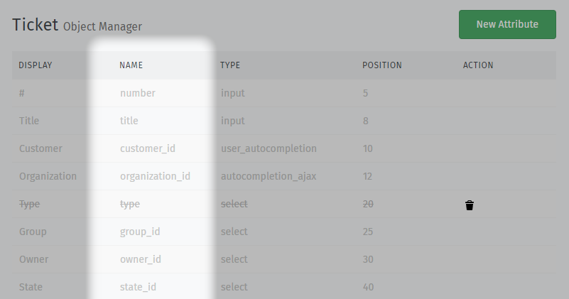

Find a complete list of ticket attributes in the Object Manager.¶
Ticket attributes are entirely optional, and can be used to customize the tickets that Checkmk creates. (Note that these attributes will be ignored if a new event belongs to an existing ticket.)
Why would you want to do this? Maybe you have only one IT guy, and all system monitoring issues should be automatically assigned to him. Or, maybe you’re creating multiple notification rules so that database outages take higher priority than disk space warnings.
In most cases, you’ll probably want to set one of the following:
group
owner
state
priority
but in practice, you can set almost any attribute, including custom ones you created through the Object Manager.

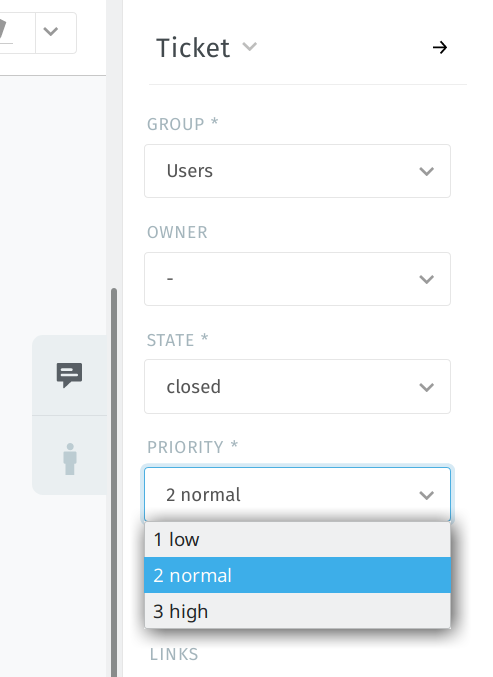

- group & priority
Refer to the dropdown menus in the ticket pane:
-F "group=Users" -F "priority=3 high"
