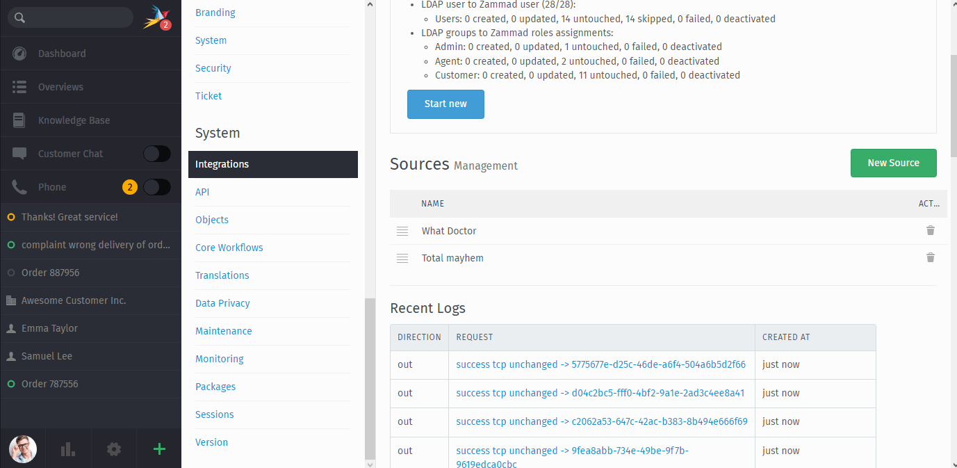

- Review or edit existing source
Clicking on a LDAP source will provide a configuration and mapping overview.
If needed you can then use the Change button to update either the name, active state or the whole configuration. If you’re changing the whole configuration, the dialogue will be identical to the source creation.
Did your LDAP server change? Different LDAP servers have different structures and default attributes. This causes the LDAP synchronization to likely fail. Consider removing the affected source and re-add it.

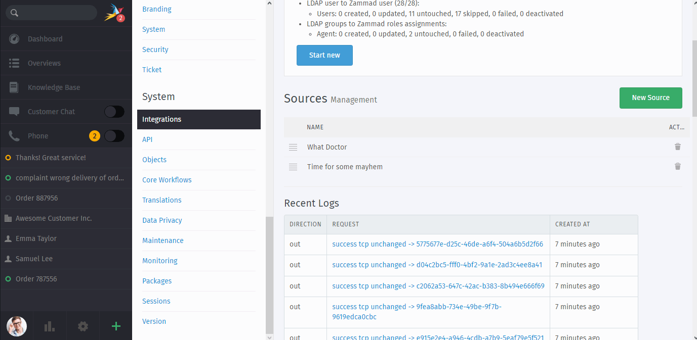

- Re-arrange LDAP source’s order
You can change the synchronization order for each source at any time. Zammad will synchronize the sources from top to bottom.

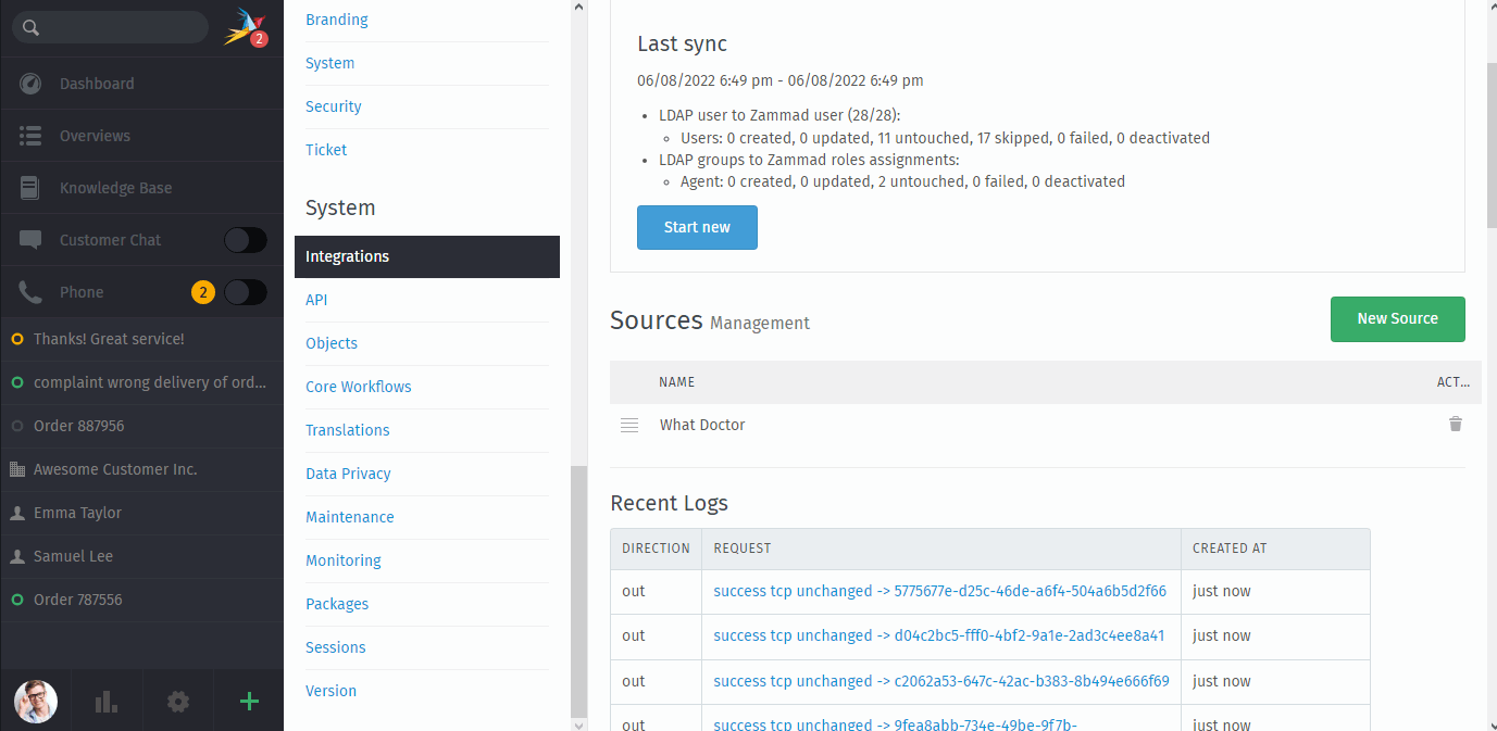

- Remove a source
If you no longer need the a LDAP source or simply want to start over, you can remove them at any time. This will not remove synchronized users, data synchronized or permissions.
Tip
Not sure if you’d need the source later on? Set the source to inactive instead of removing it - see Review or edit existing source for more.
