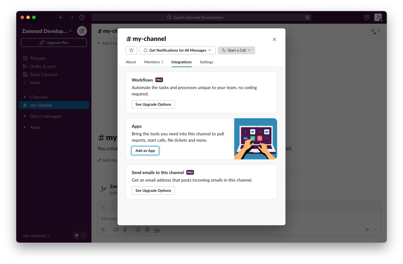

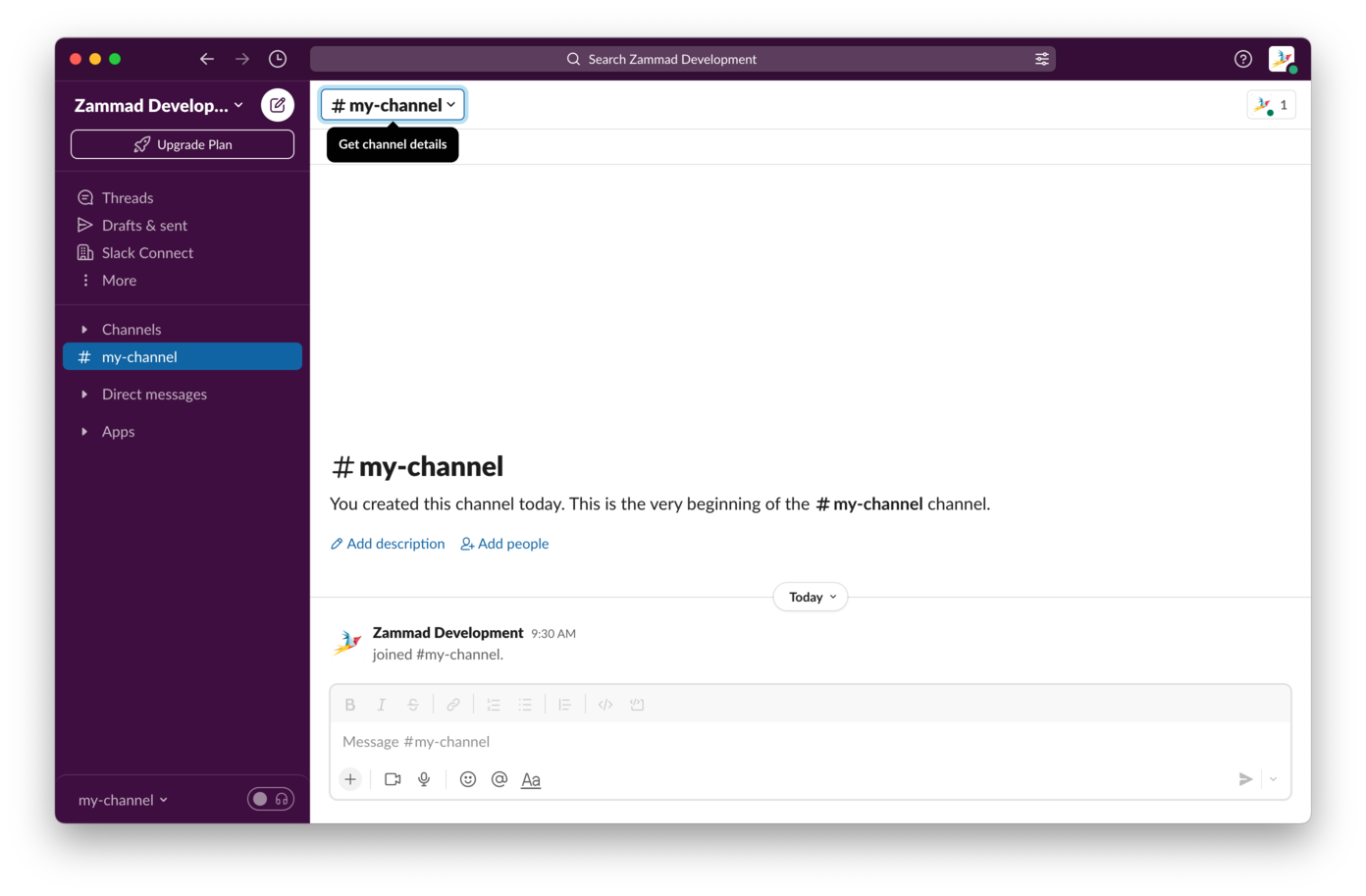

In your target Slack Channel, click on the channel name in the upper left part of the screen to get to channel details.
Switch to Integrations tab and click on Add an App button.

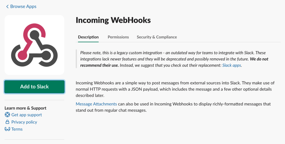

You will be redirected to the Slack App Directory website, where you can add the app.
Click on Add to Slack button.

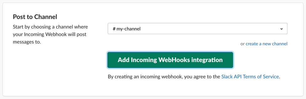

On the next screen, in Post to Channel choose your channel from the list and click on Add Incoming WebHooks integration button.

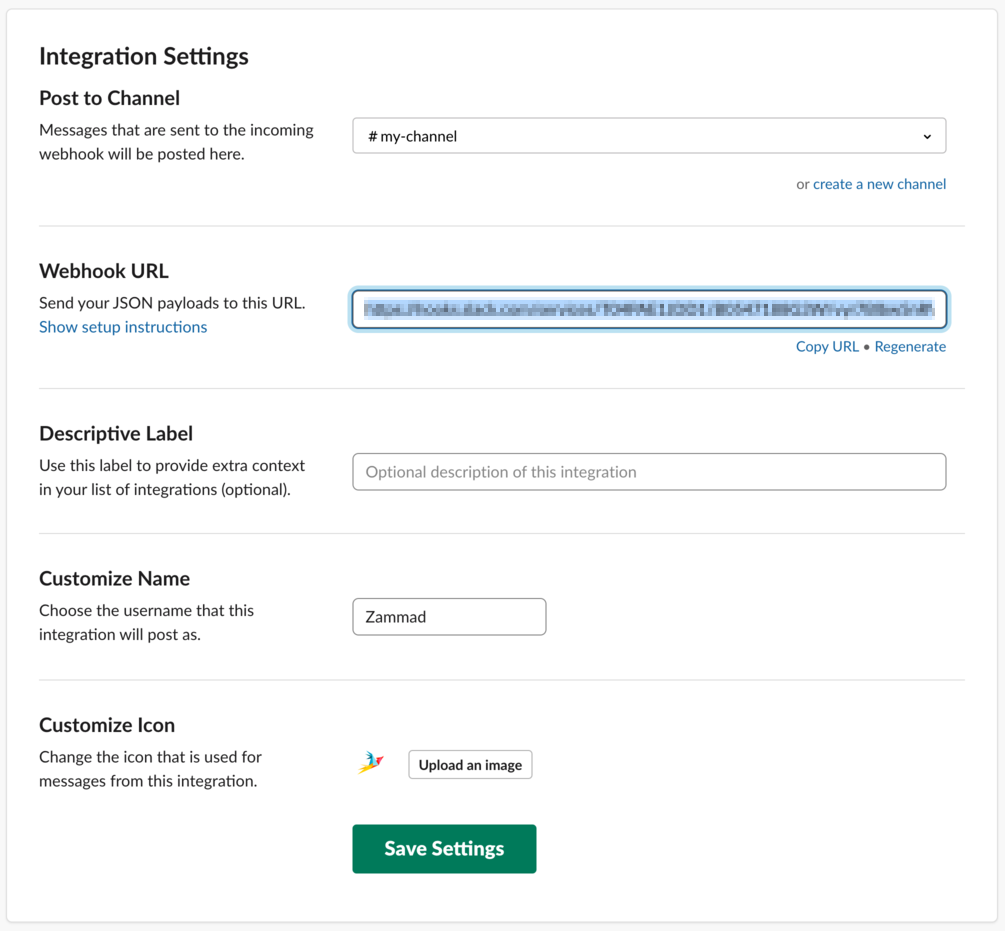

In the final screen, scroll down to Integration Settings.
Make sure to copy Webhook URL to clipboard and save it for later. You can do this in one click via the Copy URL link shown right below the field.
You can also fill Customize Name field with an appropriate username for the incoming webhooks integration, as this will be used for all of the notification messages in the channel.
Optionally, you can Customize Icon which will be used as the avatar.
Finally, save your app configuration by clicking Save Settings.

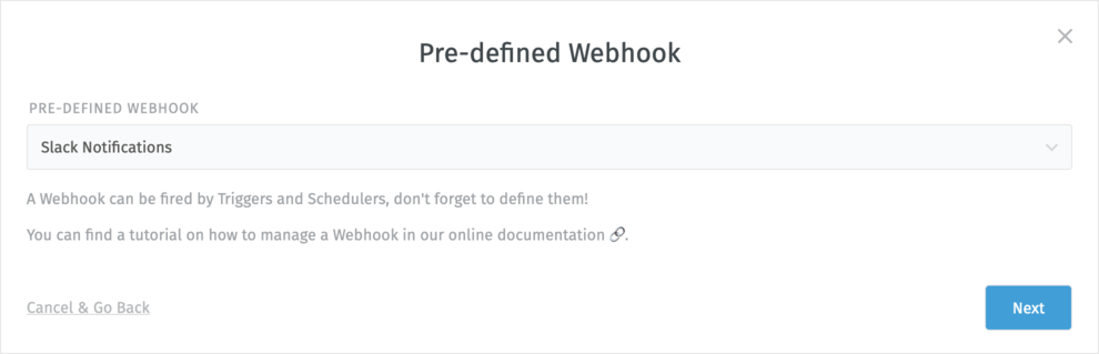

Go to Webhook management screen in your Zammad instance and click on the arrow next to the green button in the upper right corner. Choose Pre-defined Webhook from the dropdown menu.
In the subsequent modal dialog, select Slack Notifications as the pre-defined webhook.
Click Next.

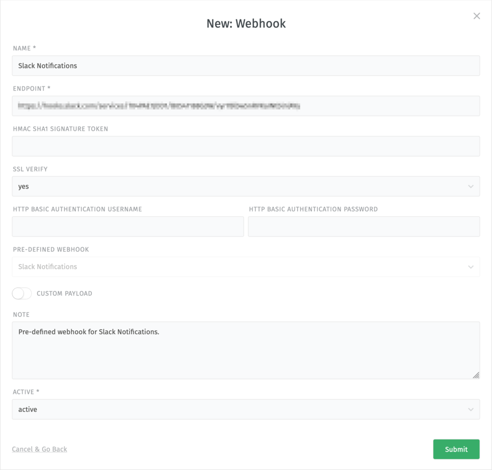

In the new dialog, paste Webhook URL from Slack App into Endpoint field.
Finally, click on Submit.

Find your webhook in the list on the management screen and click on it to edit it.

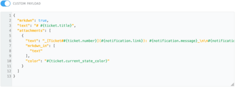

Switch on Custom Payload and the code editor below will be shown, pre-populated with the default payload.
Next, identify the line starting with "text": "... block in the JSON
structure.

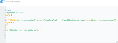

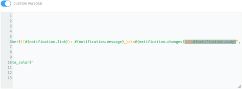

Scroll horizontally to the end of the line and select
\n\n#{notification.body} part near the end. Be sure not to include the end
double quote with comma (",) in the rest of the line, since the new payload
must remain a valid JSON value.
Then, simply delete the selected code.
Finally, click on Submit to save your webhook changes.
