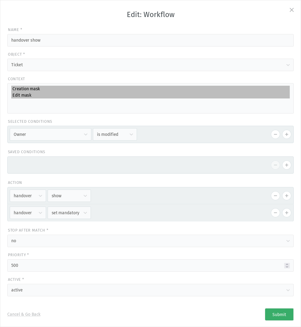

This workflow shows the field and sets it as mandatory when another ticket owner is selected. This workflow has the default priority so it runs after Workflow 1.
Area
Configuration
Object
Ticket
Context
Creation mask
Edit mask
Selected conditions
Owner is modified
Selected condition because it has to be
checked before changes are saved.
Saved conditions
Action
Handover show
Handover set mandatory
